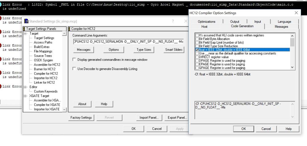

Does anyone know why exactly I am getting these errors?
I have already changed the standard settings -> Compiler for HC12 -> enabled floating points.
Would really appreciate if anyone could help me with that.

Creating new project you told project wizard you do not want floating point.
Linker complains because library included in your project doesn't contain _FADD, cos and other floating point routines. See \CWS12v5.1\lib\hc12c\readme.txt on your drive for, then delete reference to bad *.lib and re-add the right one.
Looks like you have ansisi.lib included while you want ansisf.lib.
