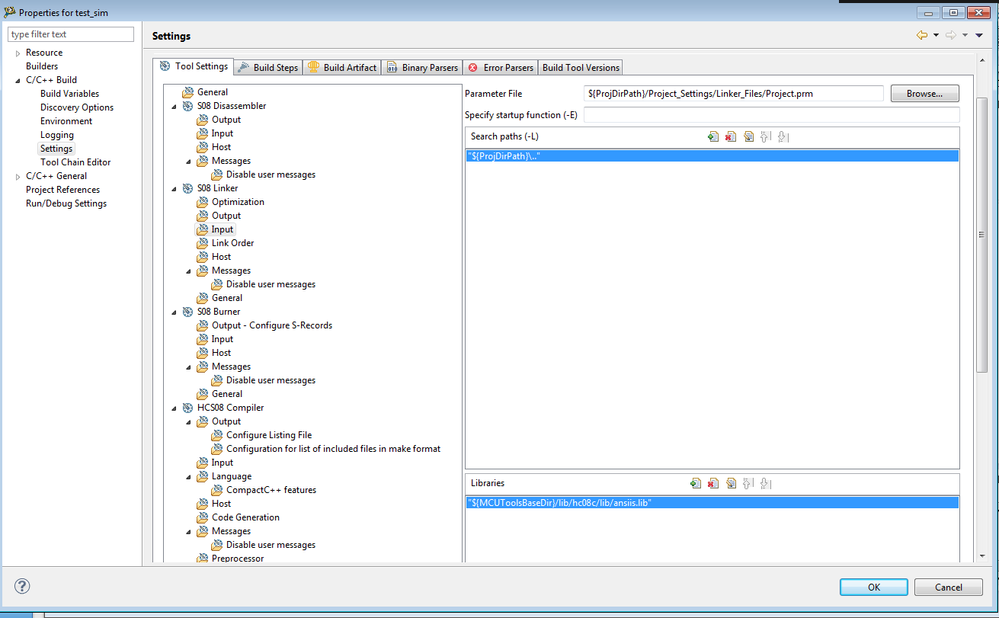

trytohelp
Hi Huck,
I tried to reproduce the problem on my side without success.
I used the last version CW for MCU V10.5.
In the Project Properties for the linker settings you can add paths.
Probably the second prm file is linked to the project through a path.
Please check the paths listed to:
Pascal

hucklim
Hello Pascal,
I am trying to see the path set in the linker. However, I cannot find the path llisted and the picture you attached is for the Eclipse IDE. I am using Codewarrior for HCS12 (IDE Version 5.9.0). Can you please tell me how to find the linker path on my IDE? The only path info I find is the 'access path'.
Yours sincerely,
Huck

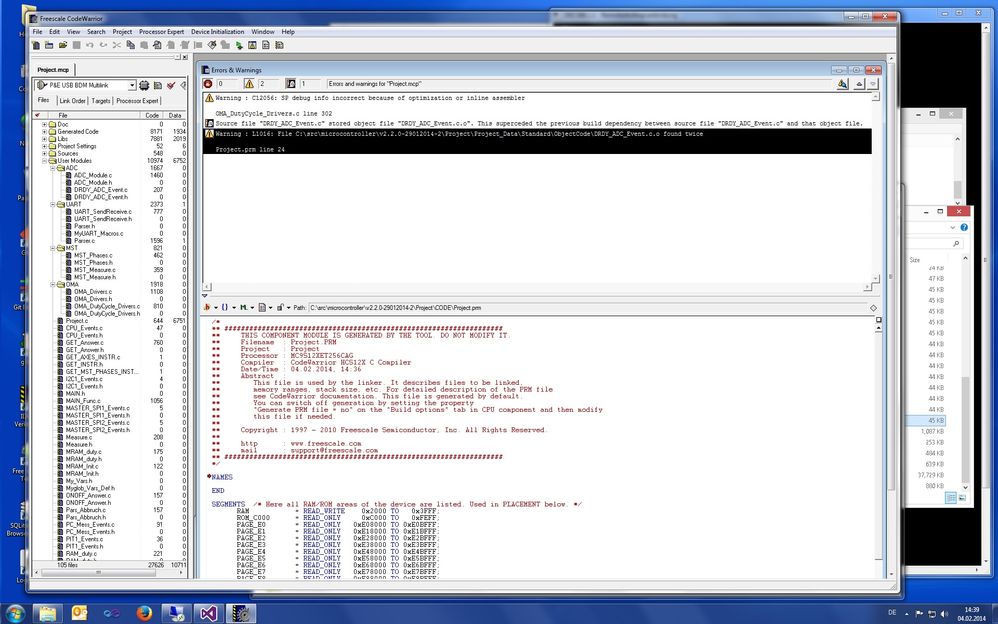

I have a screen shot of my Codewarrior IDE, which shows the L1016 warning that I am getting.
Unfortunately I am not able to send you the application because of company policy.
Let me know if you found anything.
Yours sincerely,
Huck

hucklim
Hello Pascal,
hier is the snap shot. I wonder if you can see/read the L1016 warning.
4,786 Views
trytohelp
Hi Huck,
you're using Processor Expert too.
I don't know if the L1016 message is linked to the previous Information message saying:
      Source file "DDRY_ADC_EVENT.c" stored object file "DDRY_ADC_EVENT.c.o". This superceded the previous build dependency between source file "DDRY_ADC_EVENT.c" and that object file
Can you try to remove all objects code before to build the project ?
Do you get these 2 messages again ?
I don't think I could provide you more info/help without the project.
Pascal

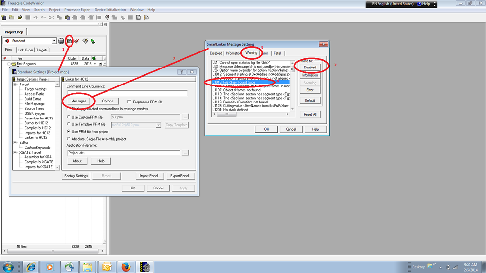

trytohelp
Huck,
Without the project I could not help you to solve the problem.
Now it's possible to disable this message.
Please see below.
in this case the message will be listed in disabled.
Pascal
