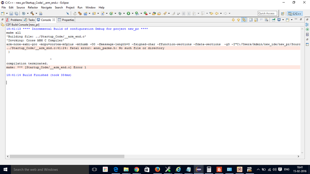

    I tried to run KEA-128 on Eclipse.It throwed me this error in arm_end.c.
How to fix this?

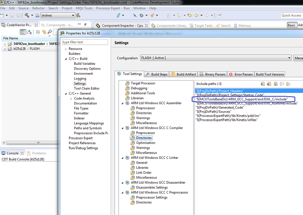

TICS_Fiona
Hello Vignesh
By default, the head file " ansi_parms.h" locates under:
C:\Freescale\CW MCU v10.6.4\MCU\ARM_GCC_Support\ewl\EWL_C\include
Could you please check whether this path is included in Project Properties?  You can do it from <Project> Menu->Properties, then go to "C/C++ Build-> Settings" panel, then choose "ARM Ltd Windwos GCC C Compiler-> Directories", please check whether the above path is correct. Please see the attached screenshot.
Hope this helps!
