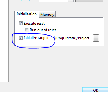

santiago_lopez
Daniel,
You are using MQX, try re-enabling the target initialization and let me know how it went. I will try to replicate your problem in my board.

danielchai
Senior Contributor I
Hi Santiago,
I tried checking Initialize target. It gives me another error:
How does this file miss?
Thank you.
7,654 Views
dereksnell
Hi Daniel,
That is not the right path to your .TCL file, at least that is not where MQX usually has those files.  The default location is \Freescale_MQX_4_0_1\lib\twrk60f120m.cw10\dbg.  And after fixing your initialization file location, you will probably need to fix the memory file and path for the .MEM file as well.
It appears your Debug Configuration was altered, which has caused all these issues.  I just tested the gpio_twrk60f120m using MQX v4.0.1 and CW v10.4, and it has no issues downloading and running on the TWR-K60F120M board.  If you continue to have these issues, I suggest you start with a clean project, maybe reinstall MQX if needed, so the Debug Configuration will have the default settings, and you won't need to clean it up.

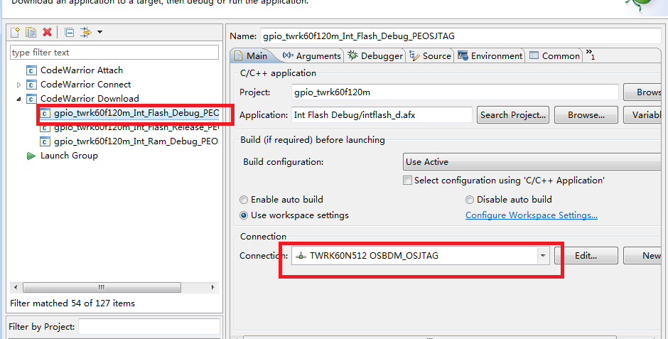

danielchai
Hi Derek,
I just noticed that when I configure the Debug part in the project. It use TWRK60N512 OSBDM_OSJTAG for project gpio_twrk60f120m.
Do they share the same debug file?
Thanks.
-Daniel

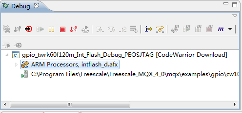

danielchai
Hi Derek,
I step through the code, and I found it is stuck in init_hardware.
When I suspend it, it stops at:
What's the possibility causing this?
Thank you.
7,654 Views
santiago_lopez
Hi Daniel,
The code is getting stuck in the clock initialization. At the beginning MQX initializes the clock settings to achieve certain core and bus frequencies. By default, the clock settings are configured to use the crystal/oscillator populated on the Freescale Tower Board the BSP was developed for. If you are using a different crystal/oscillator you will have to reconfigure the BSP to use the new component and be able to exit that while loop your code is getting in. Please try changing the clock configuration on the BSP to match the crystal/oscillator you are using in your custom board.
