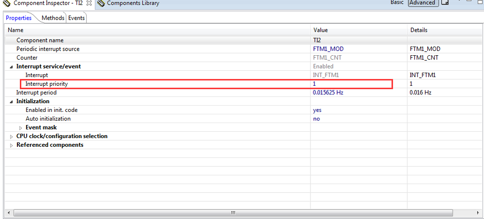

But the code generated by PE wizard:
//Enable Interrupt
NVICIP63 = NVIC_IP_PRI63(0x80);
/* NVICISER1: SETENA|=0x80000000 */
NVICISER1 |= NVIC_ISER_SETENA(0x80000000);
FTM1_SC |= FTM_SC_TOIE_MASK;
_int_install_isr(LDD_ivIndex_INT_FTM1, FC1_OnOverflow, NULL );
Why use NVICIP63 = NVIC_IP_PRI63(0x80); ?

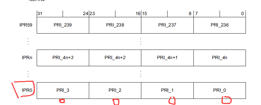

IPR registers contains 4 bits as stated in the section 3.2.2.1 Interrupt priority levels.
I am a little confused. What are priority levels (0-15 with 0 as highest priority?) or priorities from 0 - 0xFF ?

Hello David,
- Which version of IDE do you used ? I used the CW 10.6.4, when i set the FTM1 priority to
"1" , the generated code is :
  /* NVICIP63: PRI63=0x10 */
  NVICIP63 = NVIC_IP_PRI63(0x10);
The result is right .
- For this device ,  one byte(8 bit) support one interrupt priority use the NVIC_IPR register ,
while the low 4 bits have no effect, the default data is "0000" , so only the high 4 bits indicate
the priority .  For example , if the priority is "1", the data should be 0x10, not 0x01 .

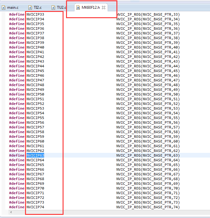

- About "NVICIPR15" , this is the define register on ARM M4  core, while , in this chip ,
it doesn't defined as this name .  As we know , on NVICIPR register includes 4 bytes ,
in this chip , defined all the bytes :
From the RM of K60, we can see FTM1  IRQ is 63, so the result is   NVICIP63 = NVIC_IP_PRI63(0x10);
Does this can helps you ?
