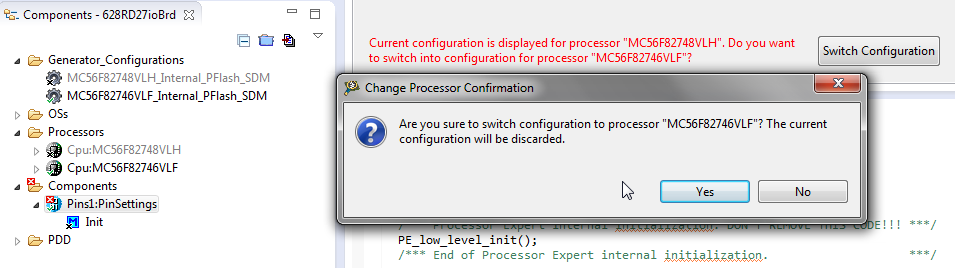

I am using a MC56F82746 in a project but have an EVM with a MC56F82748 on it.  I want to do preliminary coding on the EVM and then easily switch it to the production board using the other processor.
I can add a second processor to the PE project but when I switch between them it comes up with the following message.
Is there a way to do this without loosing configuration for a processor?
Is the problem just for the Pins1 component?
Is there a better way to do this?

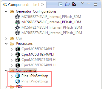

you could add another PinSettings: configure it so it is active for the given CPU configuration, e.g.:
Inside the PinsSettings, there is a button to move the configuration (to apply for a new CPU).
You can copy your existing one (copy and paste with the context menu), and then configure it for your configuration (Configurations with Processor Expert | MCU on Eclipse shows how to deal with configurations).

With your Configurations link I was able to add 2 PinSettings components and enable them in different cofigurations and the IDE seem happy.
