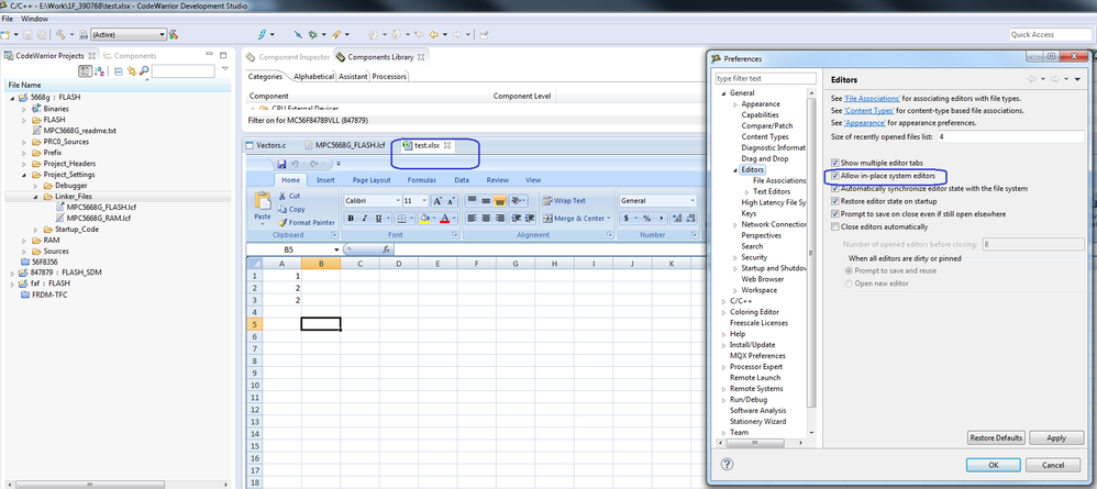

Hello Ankur
Eclipse CodeWarrior for MCU supports exporting trace data to Excel,  as well as the registers information.  But I cannot find a way to import the data into CodeWarrior from Excel. However, you can open Excel file directly in CodeWarrior,  just drag the file into IDE. Before  it, please make sure  that the "Allow in-place system editors" option is checked.
