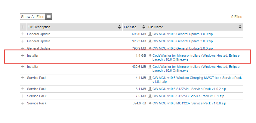

I have downloaded and installed Code Warrior 10.6 from the Freescale site, but when I installed, the installer wasn't able to access the processor specific files because our network proxy would allow it access.  I tried to provide proxy settings and login credentials, but nothing would work.
So now I have it installed, but I have no way to compile my project.
Is there any place I can download the necessary files and then incorporate them into Code Warrior via some kind of "offline" method?

Hi Andrew,
To download the offline installer you must access it via the download page.
As you can see there are 2 installers:
      Offline one 1.4GB
      Online one 432 MB
