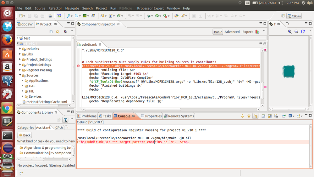

I am using code warrior 10.2 for development. I am taking help of Application Note AN3906 for implementing a serial to ethernet bridge. I have also downloaded the software for AN3906 and imported it into code warrior as a project.
Whenever I try to build the project, I get an error as in the attached screenshotScreenshot from 2018-01-18 14_27_57.png
The highlighted line reads as follows.
Libs/mcf51cn128_c.obj: /usr/local/Freescale/CodeWarrior_MCU_10.2/eclipse/C::/Program\ Files/Freescale/CW\ MCU\ v10.1/MCU/ColdFire_Support/Derivatives/device/src/mcf51cn128.c
I know here there is a conflict between windows and linux paths. But how to change the settings so the project only takes a linux path.
Also the readme.txt with the application note states that the sw is compiled for CW 10.1 , and I am using 10.2 so will this work.
