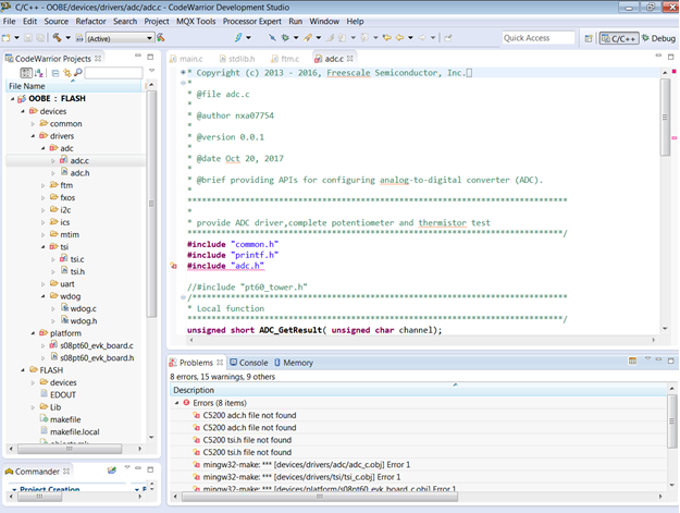

It turned out to be a project configuration issue.  When I download S08PT60-EVK Example Codes it unzips into 2 folders:  'devices' and 's08pt60_evk' - which is the project folder.
After I copied the project to the local directory in which I would be working, I mistakenly put the devices folder within the s08pt60_evk.  After realizing the mistake, I started the project creation process again with leaving the devices folder at the same directory level as s08pt60_evk.  The project then compiled.
However I noticed that the project only "recognized" the 'common' and 'drivers' folder underneath the 'devices' folder.  It also did not recognize other folders underneath the 'drivers' folder.
I subsequently decided I wanted to use some of the functions in the s08pt60_evk_board.c file which was under the 'platform' directory under 'devices'.
So I then copied the 'platform' directory' into the 'devices' directory underneath the project.  I also copied the needed adc folder and files along with the tsi folders and files into the 'devices' folder which the s08pt60_evk_board.c file needs.
However, codewarrioir will not recognize the files and folders that I added.  See screenshot:
How do I get CodeWarrior to "recognize" the added folders/files?
Thanks so much.
Rick

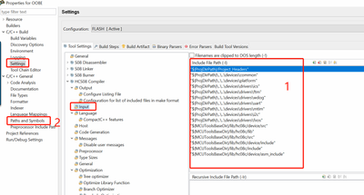

3,087 Views
ZhangJennie
Rick
You need to make sure the file path is included in project path settings.
Jun Zhang
