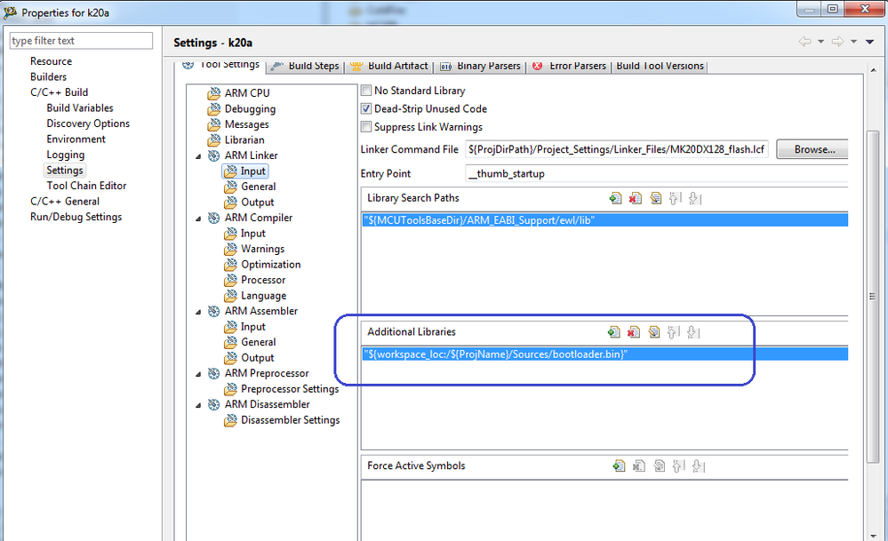

This topic has lots of traffic but no workable solutions that I have found in the forums or help or docs.
In short, the INCLUDE command in the LCF can never find the file no matter where I add the file to the project.
It is simple to repeat, just create a new CW10.3 Kinetis bare board project and add "INCLUDE bootloader.bin" to any section in the lcf. Then add the bootloader.bin file to the project via right click, add files... (file contents does not matter).  On build you get this error:
>Linker command file error at line 24
>File not found: bootloader.bin
I have put the file in nearly every referenced directory of the project and it can never find it.
Any ideas?

Please check whether you have added the (.bin) file in Linker Input Settings.

Thanks Fiona, answer is right on.  Have an upvote.
