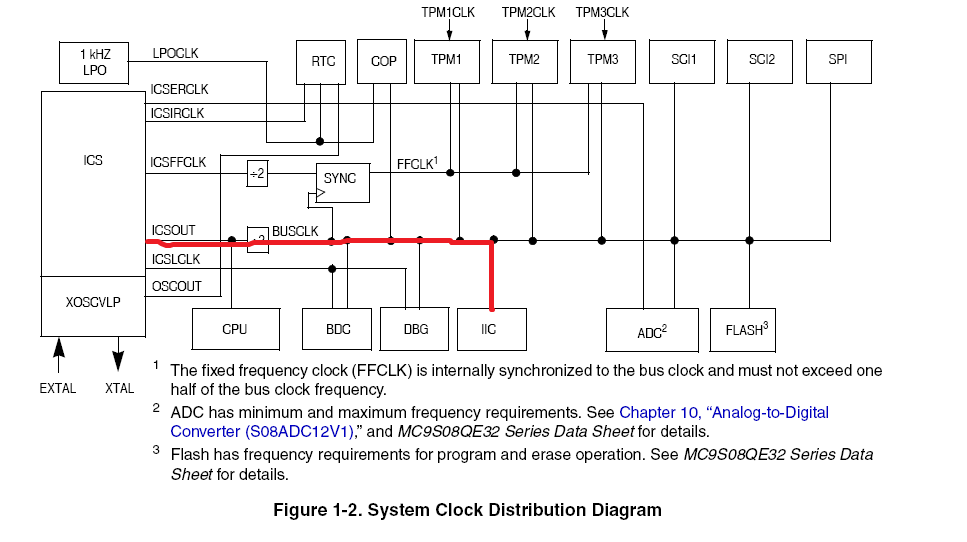

I'm new in the Freescale Universe, and I have a practice with a MC9S08QE32CLD for comunicate with a MCP23017, I have a problem with the set up for the I2C communication process.

Hi karguar,
i don't know MC9S08QE32 cpu but i have read only its RM. Have you read RM??:smileywink:

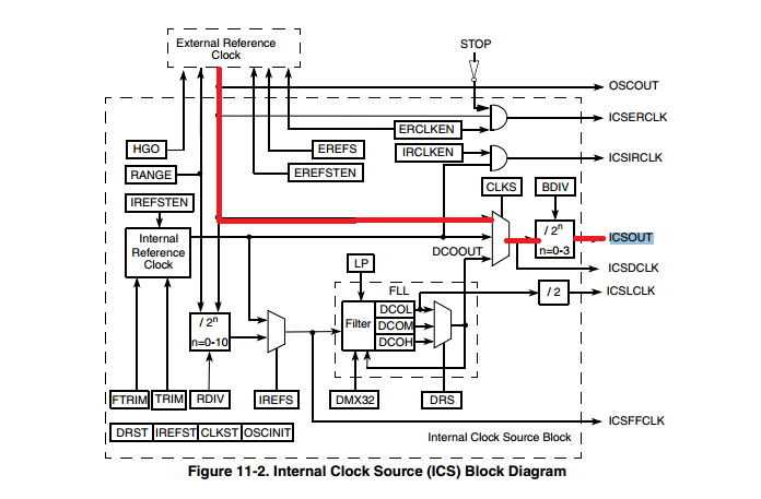

The clock used by I2C is ICSOUT as shown in screenshot:
In the clock block diagram you see that ICSOUT can be referred to the external clock source setting CLKS and BDIV.
To configure external clock for I2c you must have:
ICSC1 = 0b10000000;
ICSC2 = 0b00101010;
I hope it helps.
Regards!

I want to  work with a external clock 10 MHz, I think that it's the issue, because i don't know how configure the external clock.
