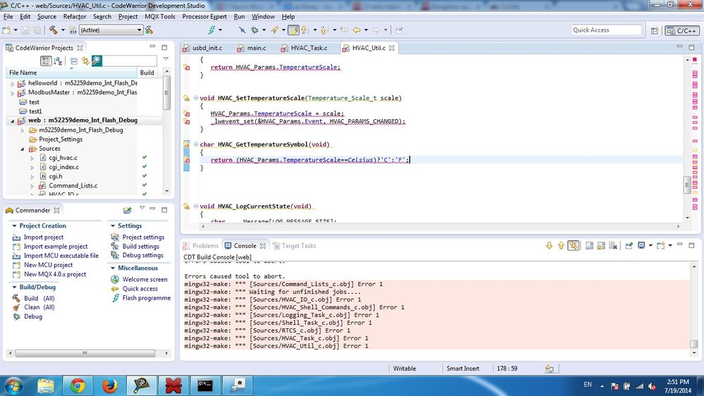

santoshkubasad
Hello Jorge,
     Thanks for the reply, issue solved, but recently i tried to update codwarrior to version10.6 and MQX to 4.0.2 when I create a new sample project of existing example project I am getting lot of compiler errors. Do I need any extra patch or any software to get the program executed. I have also attached the snapshot of the example project for your reference. Please guide me. Thankscw10.6.jpg
