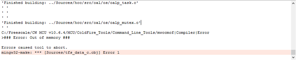

Our [bootloader + application] has 8 MB as the rbin size. Currently we are trying to add a 13 MB external s19 to the rbin
as a tfsdata. During compilation we get the following error on the code warrior(10.6.4).
">### Error: Out of memory ###
Errors caused tool to abort." in the compiler.
We tried increasing the heap size for eclipse to 768M from 512M [Default]. Still we get the same error.
