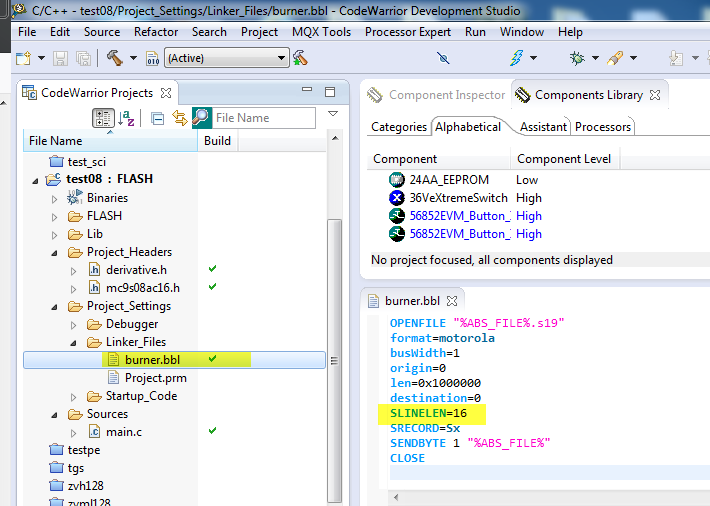

I need to limit the number of bytes in an srecord line in CodeWarrior 10.7 .How do I set the default to only allow 16 bytes per line.

I guess I should mention that we are using the S08 toolset, do you have the options for the S08 burner tool?

Fred,
If you use s08 device, it's easier. Just add command
SLINELEN=16
to burner.bbl file.
save and rebuild. We will see the new generated s19 file is 16bytes per line.
For more information about SLINELEN, please perform "search" in CW10 help .

Hello, I have another question. I need to generate an S-Record file that pads the unused memory location from 0xC000 to 0xFFFF and each record must contain 32 data bytes. Is there a straight forward way to do this with the S08 linker or burner?

Hi Fred,
see <CW Install>/MCU/Help/PDF/MCU_Build_Tools_Utilities.pdf:
the burner has the SLINELEN command which you can use to limit the S-Record line length.
And the Linker has the FILL command which you can use to fill a segment with a pattern.

Excellent! That works perfectly.
