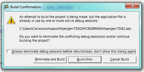

Hello, I clicked in the "Always terminate debug sessions before rebuild/clean, don't show again" checkbox, but now I would like this dialog to show again.

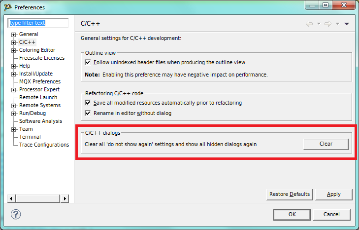

I've searched a lot in the preferences and configurations and haven't been able to find a way to make it appear again, I've only found this:
Over Window->Preferences on the menu bar. But I don't like to reset all of them.
Where is the preference to show that dialog again?
Thanks.

Hi Carlos,
have a look here:
Show it again! (How to re-enable hidden Dialogs in Eclipse) | MCU on Eclipse
Your dialog is shown under the section
Build/Clean while Debug
I hope this helps,
Erich

Thanks so much Erich!
