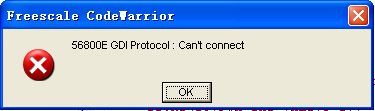

My program runs successfully in another computer. The version is same. But I have failed many times with my own computer. I'm not sure if i missed something when setup the software.

Now I think the device driver is ok. But i still have the problem 'gdi protocol'. And the massege have changed from 'cant load gdi dll' to 'cant connect'. I want to show you my screenshot.
PS: I run this software in VMware virtual machine with WIN XP(because my computer system is win8 64bit). And the pictures below shows condition of the virtual machine(WIN XP).

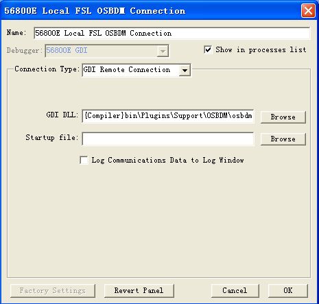

Are you using the same hardware board on another computer? Would you please help me to check:
1) The connection setting in CodeWarrior
Please open Target Settings by ‘ALT’+’F7’ key, then go to Debugger->Remote Debugging panel. If you would like to use OSBDM for debugging, please choose <56800E Local FSL OSBDM Connection>. Then click on “Edit Connection” button. On the pop-up window, please check whether you have set the GDL DLL correctly. The default location of OSBDM GDI dll is: {Compiler}bin\Plugins\Support\OSBDM\osbdm-jm60_gdi_dsc.dll.
2)The OSBDM driver
Please power on your board and connect it with PC, open Device manager, can you see this device?
6,830 Views
chenxudong
Thank you for your help. I only have one MC56F8257 board in my lab.
I have checked the first one, The  location of OSBDM GDI dll is {Compiler}bin\Plugins\Support\OSBDM\osbdm-jm60_gdi_dsc.dll.

chenxudong
