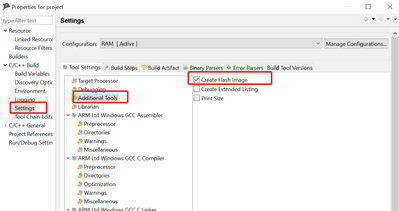

Hi, I'm trying to create an .srec, .hex and .elf for a project with an S9KEAZN168. Now I have 2 different configurations, one generate and .elf and the other one generates an .hex, but I want to generate also a .srec, and if it's possible generate the 3 in a same configuration.

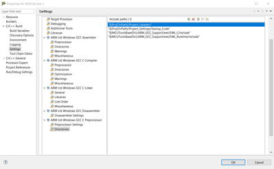

Thank you. Now the only problem I have is, I don't have those options, how could I add them? Thanks

HI @MartinFalcon95
Please check "Create Flash Image" in Additional Tool. You will see those options.

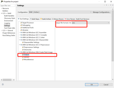

ZhangJennie
HI
You can set "Create Flash Image" to generate an image file.
If more type of image needed parallel,  Please combine the menthod as below
https://mcuoneclipse.com/2012/09/27/s-record-intel-hex-and-binary-files/
Hope this will help you.
