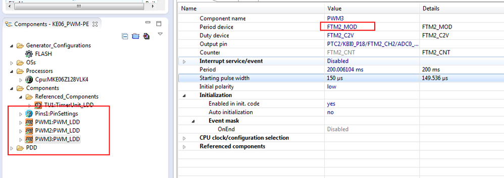

I have experience using CW 5.1 for HCS12 with Processor Expert, it was very easy to add PWM beans and asign an output to them. Now I'm trying to configure six different PWM outputs and five different Timer Interruptions, but it is not as easy as drag and drop the beans and assing an output. I can see that every PWM "module" needs a Timer Unit and the Output pin available depends on the TU that is selected. It's ok triying to configure one single PWM, but when I try to add two or more the available output pins get "locked".

About the ke06 chip, the FTM2 have six channel , and the six can all used by PWM outputs.
So when you configure the PWM on CW10.6.4-PE, please select the FTM2 , then can add six PWM channel :
If i misunderstand you , could you please send a screenshot tell me what's meaning  “the available output pins get "locked". ”
Hope it helps
Alice

Your response has been ver very usefull. Now I have 6 PWM outputs with no conflict, actually I was adding the PWM with the green icon (Hihg level component I guess) and could't make it work.
Anyway, it's working now, thank you very much.
