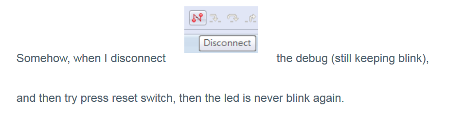

kuanyuenliao
hello,
I have my easy project to play a blink LED on TRK-KEA128
when I use debug it works well, and press reset switch
then start at "__init_registers();" and resume also continue blink well.
Somehow, when I disconnect 未命名.png the debug (still keeping blink),
and then try press reset switch, then the led is never blink again.
that's why I say the code wasn't mount in the memory, and if any debug setting is necessary but I missed, please tell me, thank you
