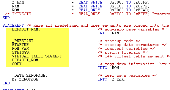

CW for HCS08 has several predefined segments. for example, see my highlight (extract from a prm file):
here we can see "startup code" and "startup data structures" are defined in segments _PRESTART and STARTUP.
If we this code
extern unsigned char __SEG_START__PRESTART[ ];
extern unsigned char __SEG_SIZE__PRESTART[ ];
#define StartLocation __SEG_START__PRESTART
#define CodeSize __SEG_SIZE__PRESTART
we should be able to get StartLocation set as 0xE000

The "__SEG_START__PRESTART" worked perfectly, getting me to 0xE000.
However, "__SEG_SIZE__PRESTART" only gives me the size of the Preamble section of code that exists before my own code in memory (0x84 bytes), but my own code occupies 0xAD1 bytes.
I need to essentially "add" the values of "__SEG_SIZE__PRESTART" and "__SEG_SIZE_DEFAULT_ROM" for my "length" calculation, but I can't do something like (see error line in red):
