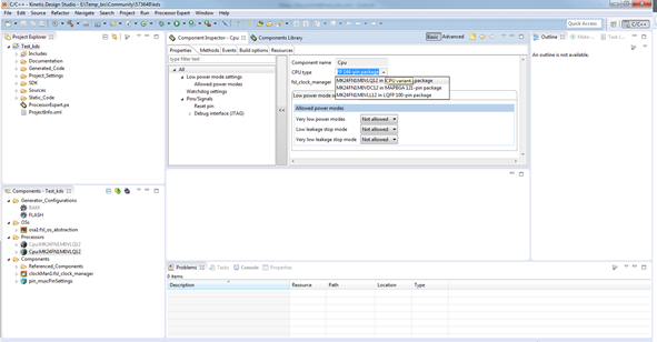

andréluis
HI Pascall,
I change to KDS and i downloaded the KSDK 1.0.3. I got other problem. When i created a project with the mk24f1m0vll12, the package don't exist. He only apear in the component library, but don't apear in the component inspector.
Thanks for the help.

trytohelp
Hi André,
Sorry but I've provided you wrong information regarding the MCU V10.6.
At this time there is no plan to include a new version of PEx in this version.
It should not be updated.
For Kinetis KDS is the right version to use.
Regarding the problem.
On my side I can select the LL12 in the CPU Type:
I'm using KSDK v1.2.0.
A new version KSDK V1.3.0 has been released too.
Pascal
Freescale Technical Support
1,469 Views
