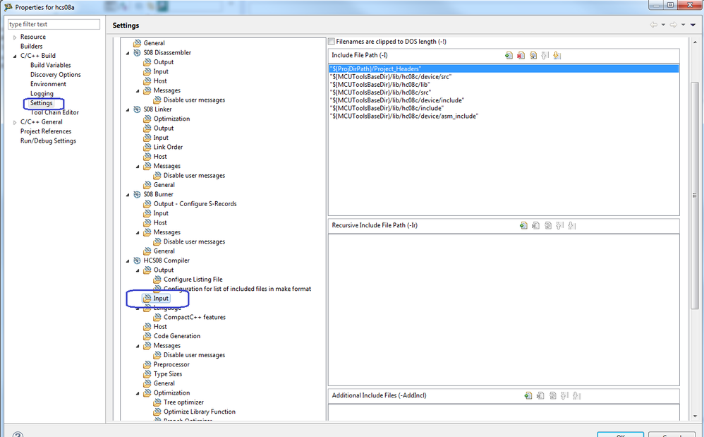

I am facing problem of toolchain and build tool. Also please give me the way to import and to build the CW Classic v6.3 project in CW  v10.6 ..
Thanks in advance

Hi Xin,
Thanks for your reply.
I am using Coldfire Compiler. And for it I have added tghe source paths for all the source folders.
But still I am facing some error like missing / expected ";" or "(" etc.
could you please help me to figure out the issues?
Thanks in advance

Hi Alice. Could you please Help  how to add paths and symbols in C/C++ General in properties of project,
Which files should be added in which tab?
Thanks and regards..
Harshit

TICS_Fiona
Hello Harshit
To import a Classic CodeWarrior Project to Eclipse CW, user needs to create a new bareboard project in CW10.6 and then add/copy all your source files to the new project. This is the cleanest way to import a project. Below is an application not for how to do this:
http://cache.freescale.com/files/soft_dev_tools/doc/app_note/AN4727.pdf
In Eclipse CodeWarrior,  user can also set the search path for head files and libraries. For head files, please set its search path from <Project> Menu->Properties, then go to “C/C++ Build”-> Settings -> HSC08 Compiler-> Input.
Best Regards
