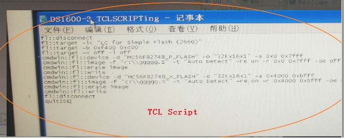

hillzzhao
I have a try it from dos shell.But it doesn't work.Could u tell me why,Please see embeded pictures.
Does it need to specify connected programmer?
2,503 Views
BlackNight
It says 'connection list is empty' in your screenshot.
I recommend that you do the steps one by one in the debugger TCL shell first, before running it as a script.
I hope this helps,
Erich

daojinwang
Dear erich,
         I have encountered same problem, I try to do it steps one by one in the debugger TCL shell. but it doesn't work. and appear "connection is empty" too. can you show us your scrrenshot that how do you do it?
fl::disconnect
fl::target -lc "LC for Simple Flash"
fl::target -b 0x80 0x1000
fl::target -v off -l off
cmdwin::fl::device -d "MC9S08DZ60_FLASH_EEPROM" -o "60kx16x1" -a 0x1080 0xffff
cmdwin::fl::image -f "C:\\tmp\\wsp_StandaloneFlsh\\Project.abs.s19" -t "Auto Detect" -re on -r 0x1080 0xffff -oe off
cmdwin::fl::erase image
cmdwin::fl::write
fl::disconnect
quitIDE
2,503 Views
BlackNight
I think you do not have correctly setup the launch configuration. I see if I can come up with a quick article with an example for the Kinetis FRDM-KL25Z board.
