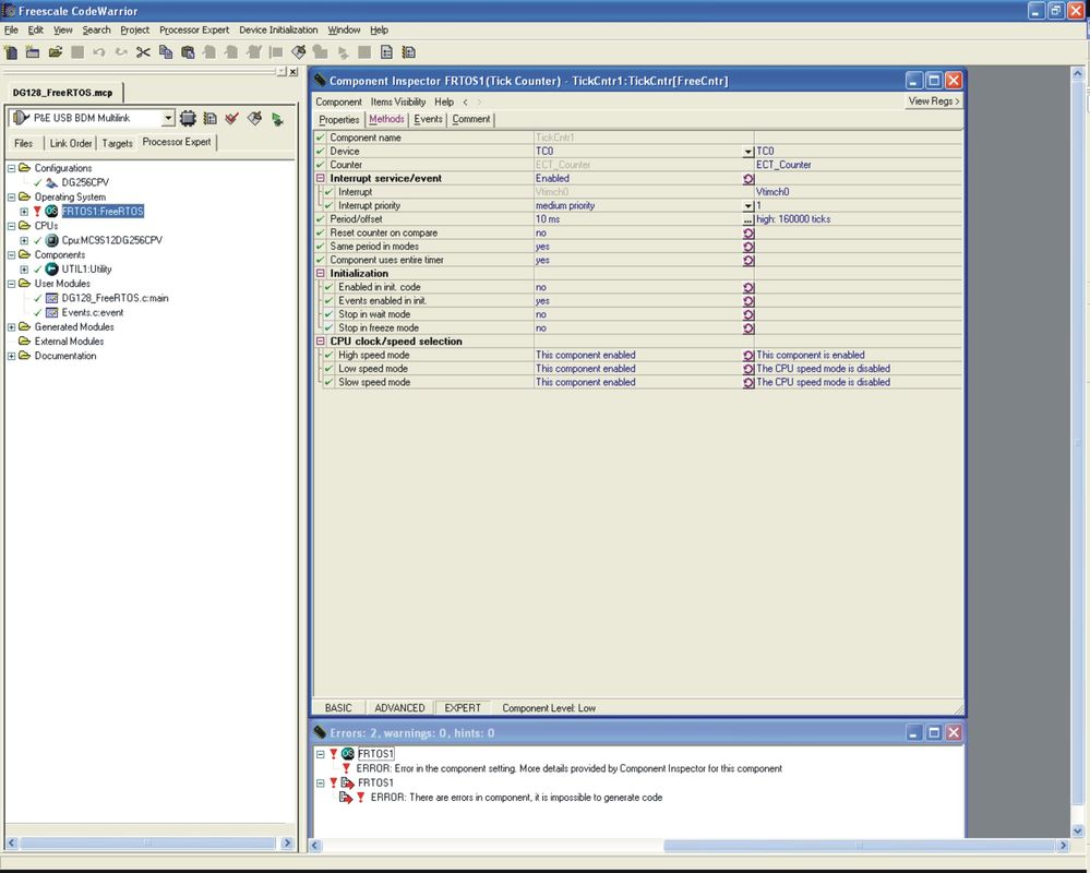

I am going to start a project with mc9s12dg256 and a project with mc9s12xdt512. Both projects will use freertos.
Processor expert for ticks->non-LDD Tick gives the following error:
"Error in inherited component settings".
I have attached a picture.
I have search at freescale forums, but I could not find anything.
I will appreciate any help.
Thank you

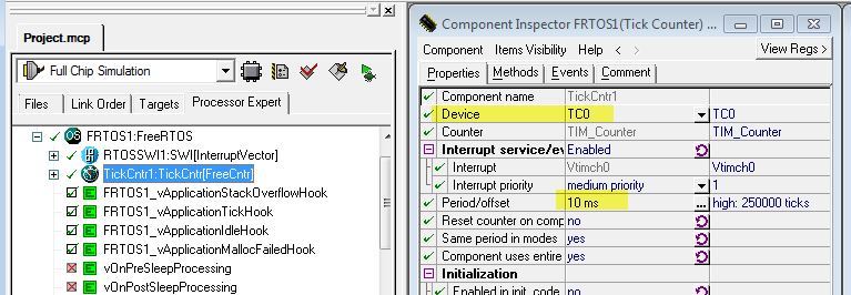

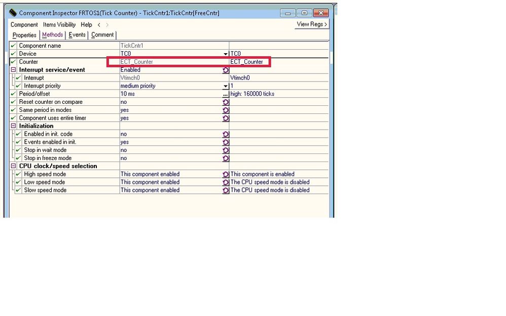

Eric_t
Hi Erich,
I have downloaded the latest components but the problems remains.
The setting are as you have proposed with the exception of the counter of TickCntr1 which is ECT_Counter instead of TIM_Counter.
Is it possible for you to attach a simple project for cw 5.1 and freertos?
Thank you
7,164件の閲覧回数
BlackNight
As that timer has no reset functionality: disable the reset method in the 'Methods' tab.
Erich

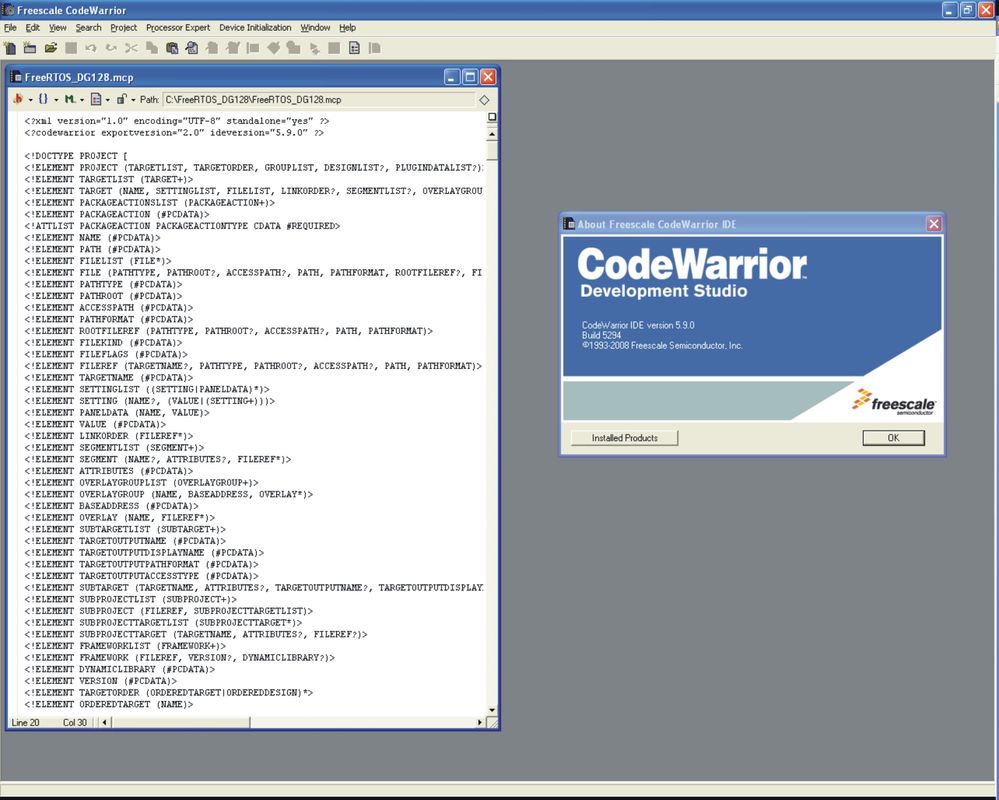

Eric_t
Erich,
Thank you for the attached project.
Unfortunately I cannot open it. CW opens the "FreeRTOS_DG128.mcp" as text file.
I am trying to attach a project (zip file), but cannot find the way.
Thank you
7,162件の閲覧回数
BlackNight
Hi Eric,
I appologize, for another test I had used 'text based project' settings.
Attached the same thing as binary project file.
Erich

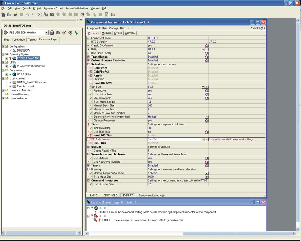

Eric_t
Erich,
Thank you for the quick response.
Unfortunately the problem remains.
The attached project gives the same error.
Ticks->non-LDD Tick-> Tick Counter-> "Error in inherited component settings".
I have attached a picture of freertos and a picture of TickCntr component.
Does the attached project compile for you?
Thank you
7,162件の閲覧回数
Eric_t
Erich,
Sorry it is my mistake.
I have used a different computer that has the outdated component.
I have installed the latest components and it seems that it is OK.
Thank you

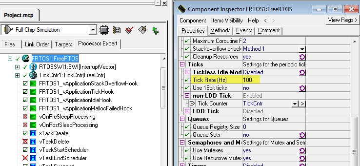

BlackNight
Hi Eric,
I believe you have not configured your timer. Make sure you use a available timer device, with a period:
The periood needs to match the Tick Rate of the RTOS:
And make sure you have a SWI selected for the software interrupt:
I hope this helps,
Erich
