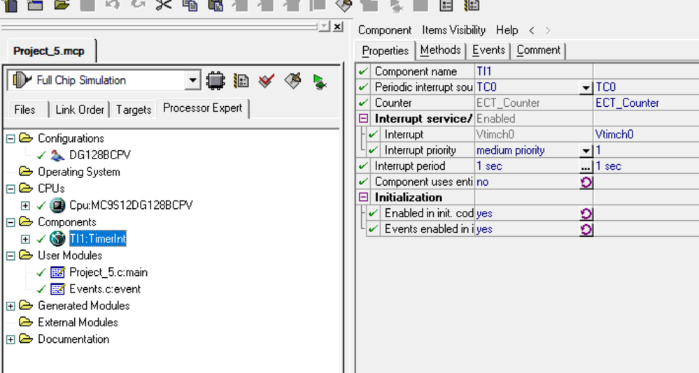

ZhangJennie
Hi Suma
I suggest you take use of processor expert component to set up interrupt period:
after generating code, take a look at the generated TimerInt initialization code.
Have a nice day,
Jun Zhang

suma_success
I cannot see the components in processor expert as I have trial version of codewarrior. Is there any method to set delay of 1 sec using timers in  main.c ?
Also , if I use RTI and Timer interrupts in the same program , what would be the priority?
Suma

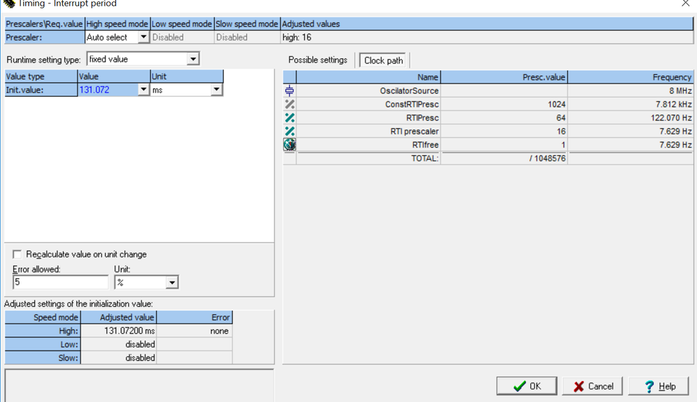

suma_success
Thanks a ton.System clock is 48MHz and Bus clock is 24MHz for Timers Oscillator clock is 8MHz for RTI . Warm Regards,Suma

ZhangJennie
Suma,
If Oscilator source is 8MHz. it's not possible to generate 1ms interrupt.see below setting. see below setting, I set the divide register to maximum, the maximal interval is 131.072ms
Jun Zhang
