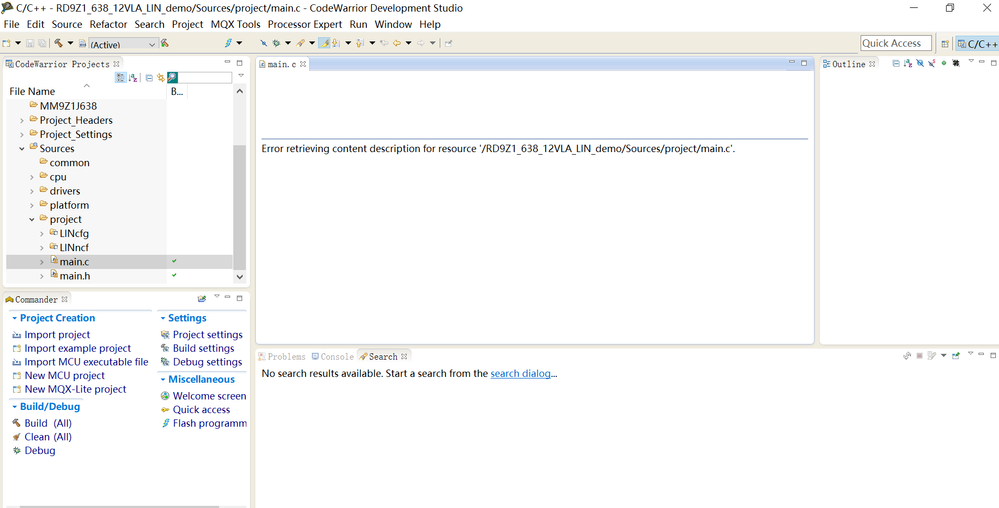

When I import project MM9Z1J638-Demo-APPSW through cw11, I have this problem. What is the possible reason?

Please make sure the "Copy projects into workspace" check box is unchecked when importing the project.
