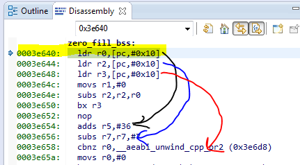

I am working on a project with 2 applications.
One builds and runs fine. The other one builds fine but crashes upon the initialization of the BSS (zero_fill_bss function). The init code is the same for the 2 apps, as for the linker file and building options.
zero_fill_bss is provided by the EWL in both cases.
The crash occurs when attempting to execute the very first instruction of zero_fill_bss. To make things clear, please have a look at the following picture:
The crash occurs when trying to execute the first instruction (yellow).
The code aims at calling memset as follow:
"memset(address_bss, 0, size_bss)"
it works as follow:
- the 3 LDR loads hardcoded parameters (the first one is the address of the BSS). Those parameters are buried into the code of the function and are accessed relatively (hence the use of PC). See the arrows. (NOTE: this implies that "instructions" from 03e654 to 03e658 are actually data)
- then it puts 0 into r1, this is the second argument to memset
- then it computes the size of the BSS (SUBS intruction)
- finally it calls memset (BX instruction)
In this case, the first LDR triggers a HardFault. I do not understand why. PC+0x10 properly gives 0x03e654 (take into account that PC was incremented since the instruction was read), which is a properly aligned address.

I have solved the problem. The HardFault was actually an asynchronous one.
Struggling to understand what was going on, I discovered the CFSR register (along with HSFR, etc). It contains flags describing the cause of a mem, bus, or usage related fault.
See ARM Information Center
My crash was asynchronous and was not related to the LDR instruction.
The problem was that the environment set the stack out of range, because of the app using too much RAM. The first instructions of the "__thumb_startup" function provided by my environment consisted in moving SP from its default - and valid - value, from the one provided by the link stage. That value was wrong (out of RAM). The attempt to init the stack failed but the fault handler was delayed.
Unfortunately no error was reported at link time.
Thanks to everyone who has read this and sorry for the inconvenience of thinking about a false problem.
