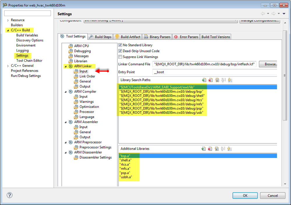

Hello Community,
Right now, I'm working on a wifi project. I use MQX 4.0.2 and installed Patch for TWR-WIFI-AR4100P. I run some demos in "atheros_wifi" folder and they work well. As I understand, all the original demo projects are linked to the wifi library files and use the functions in those files but if I create my own MQX project in CW it doesn't link to those wifi library. I tried to copy the compiler and assembler input from the demo project to my project but still I get some errors. I tried to copy one of the demos in another location and customized it but that causes the link broken to the wifi library!  So my question is how can I create a project and link to the wifi library?
The MQX tools (plugin) doesn't work with any of the demo projects.
I import web_hvac demo by drag and drop “.project” file of the project in CW 10.5 projects window and built it. Do I need to try another import approach? I appreciare you feedback.
Cheers!

Jorge_Gonzalez
Hello:
As far as I know there are no wifi libraries (or you mean the atheros source/header files?). The code for the TWR-WIFI is merged with the default MQX libraries.

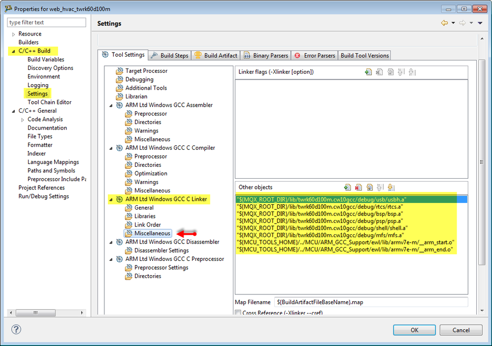

So, to use that code you just need to include the required libraries for your new project. If you open the web_hvac demo from the atheros_wifi folder, you can see the linked libraries by going to Project -> Properties -> C/C++ Build -> Settings. In the next 2 example pictures you can see the settings for the TWR-K60D100 project:
1- If using Freescale build tools you would see this:
2- If using GCC build tools:
Hope this is useful!
