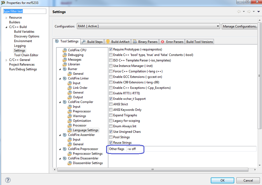

User can use -w off to disable the compiler warnings, like below:

Thanks for your answer It seems that the "-w off" flag will disable all warnings. Is it possible to disable just certain warnings, for example the "braces is non-standard" warning?
