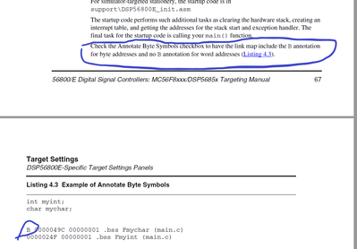

xiangjun_rong
Pls refer the description in the screenshot:
I attach the doc Targeting_56800E_cd.pdf
Hope it can help you
XiangJun Rong
