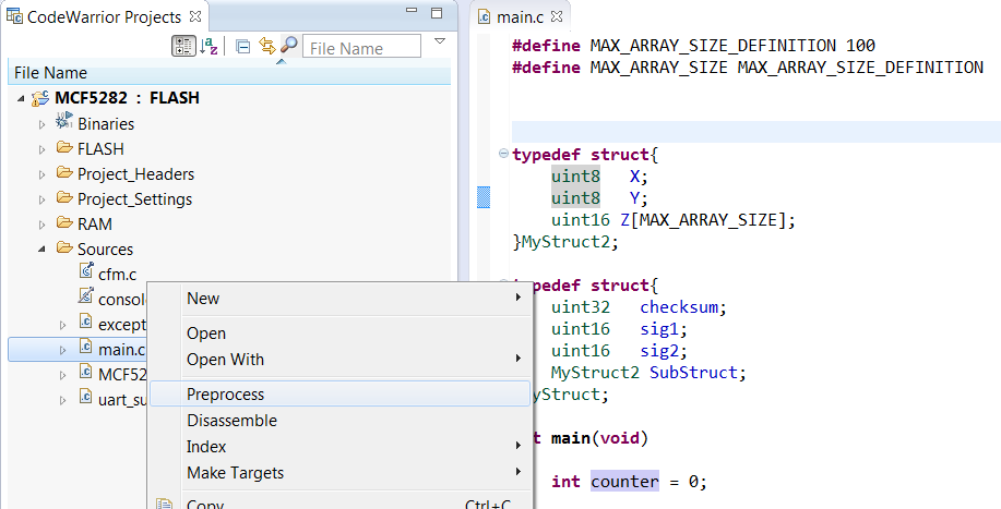

Carlos_Mendoza
Hi Marshall,
The C preprocessor macros are used automatically by the C compiler to transform your program before actual compilation, so you will need to preprocess the files so that all the substitutions are made in order to get the size of the array:
You will see that inside the generated file the MAX_ARRAY_SIZE_DEFINITION has been replaced by its value:
Hope it helps!

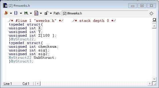

inuyashaitb
I was really hoping that would work for me. Unfortunately my pre-process did not replace all of the array definitions :\
It looks like we have different versions of software as well, maybe it was not implemented in my version?
3,126 Views

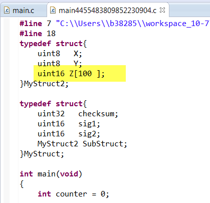

Carlos_Mendoza
Hi Marshall,
I have tested on my side using CodeWarrior for ColdFire v6.4 and it is also working:
After preprocessing the file:
Hope it helps!
