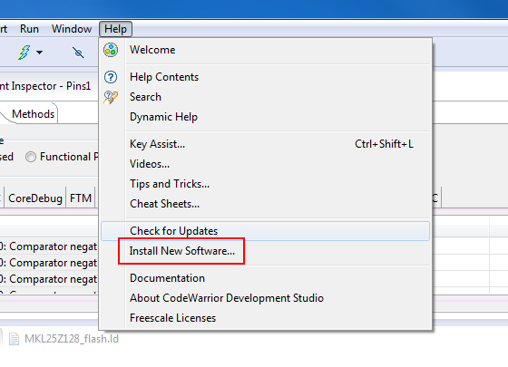

Hello HW,
Please check have you install the "MQX-LITE wizard component" here :
Hope it helps
Alice Yang
