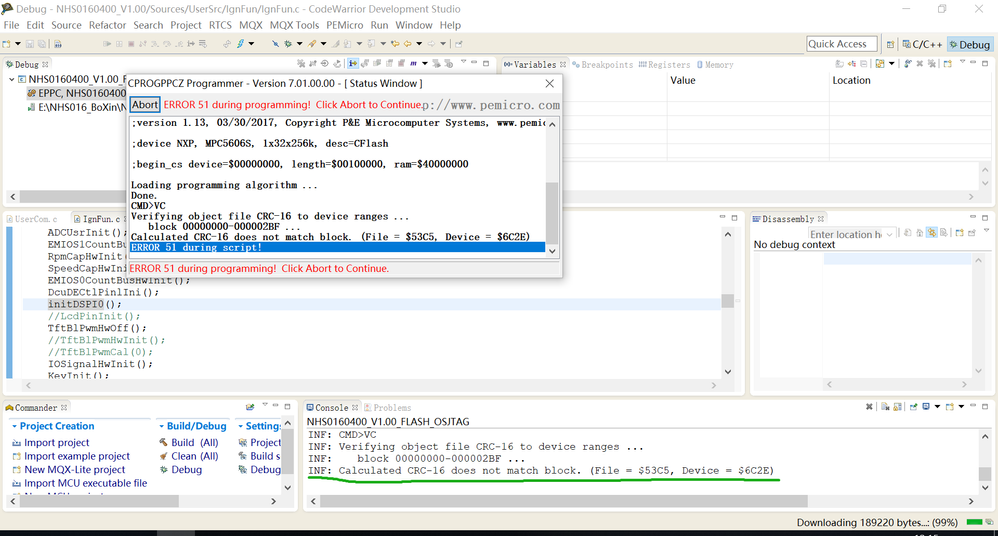

CW11.1, calculated crc-16 does not match block, SPC5606
1,621 Views
danny_li
IC: SPC5606, The old software platform: CW2.10,  but we moved to the latest software development platform ;
We are now using the latest software platforms ,CW11.1,there was an error downloading the program, as shown in the following figure:
1. But the MCU still works, Is there a potential problem?How to solve this phenomenon and problem?
1,537 Views
stanish
Which section from your linker file is associated with this address space?
Can you possibly display the the memory block (0x0 .. .0x2BF) in the debugger memory view (you can also dump the memory content into s-rec file) and compare it with the same address block in .mot (srecord) file.
This helps to determine which specific address causes this conflict.
There might be for some unknown reason 2 different blocks assigned to the same address.
Stan
