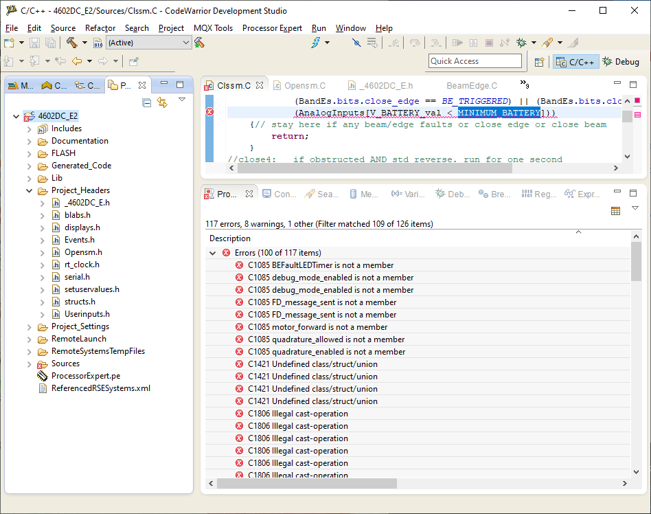

I've been working on this project for awhile, and it compiled just fine until this morning.  Suddenly it can't find files that have always been in the project, in the same folder, and haven't been modified in ages. They are all in the Generated Code folder.  I've tried everything I can think of, including powering the computer off and back on.  I'm out of ideas.  Any suggestions would be welcome.  I considered updating to 10.6.4, but that doesn't appear to be an option, the only CW version I could find is Eclipse, and I don't want to do that at this point in the project.

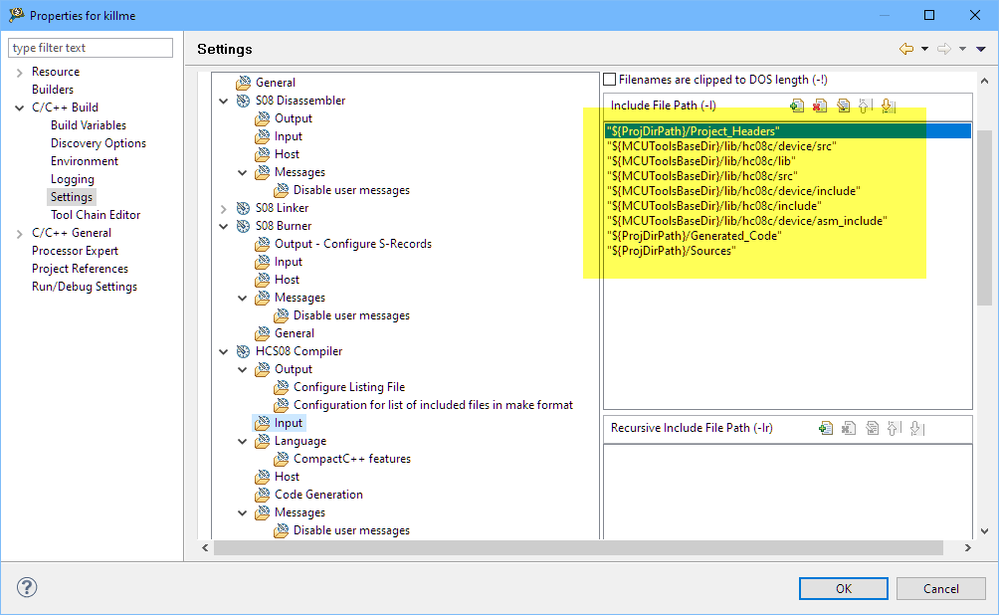

Hi Erich --
I got it looking exactly like that, and it didn't make any difference.
I tried recreating the project from scratch.  That has worked in the past, but not this time... No difference.pastedImage_1.png

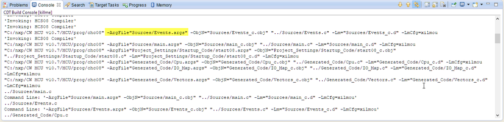

BlackNight

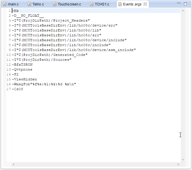

Can you verify in the Console view (compiler command line output) that indeed the correct paths with the -I option are passed to the compiler?
The options are passed with .args files:
Maybe ProjectDirPath does not get resolved on your side: does it help if you try it with an absolute path?
Otherwise: does a Project > Clean help?
I hope this helps,
Erich

GaryOlmstead
Senior Contributor I
Hi Erich --

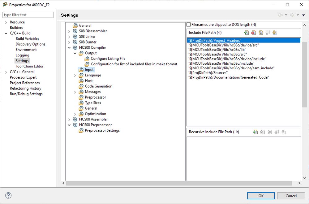

Well, mine doesn't look like yours, but this seems to be the same screen.  It has Project_Headers, Sources and Generated_Code, but doesn't make the slightest bit of difference.
2,949 Views

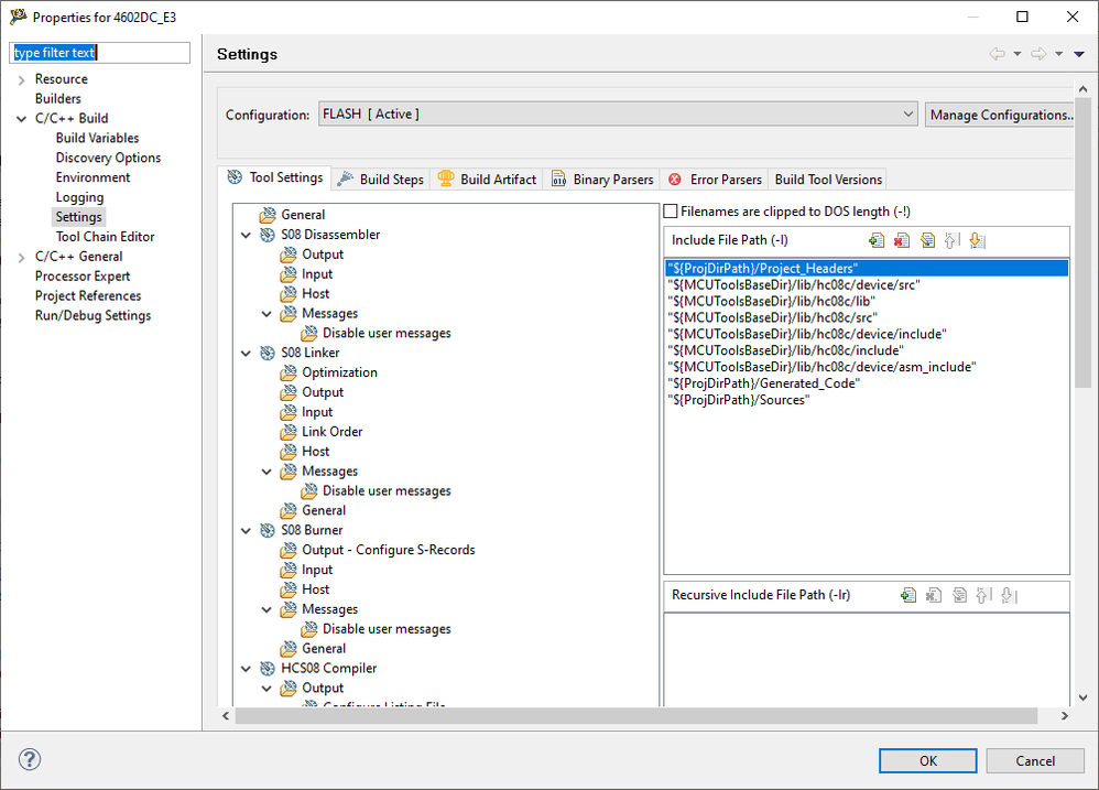

BlackNight
Hi Gary,
oh, I did not realize that you are using S08 (you did not tell this ;-) ).
Your include path for the generated code looks wrong. It should be something like this:
I hope this helps,
Erich

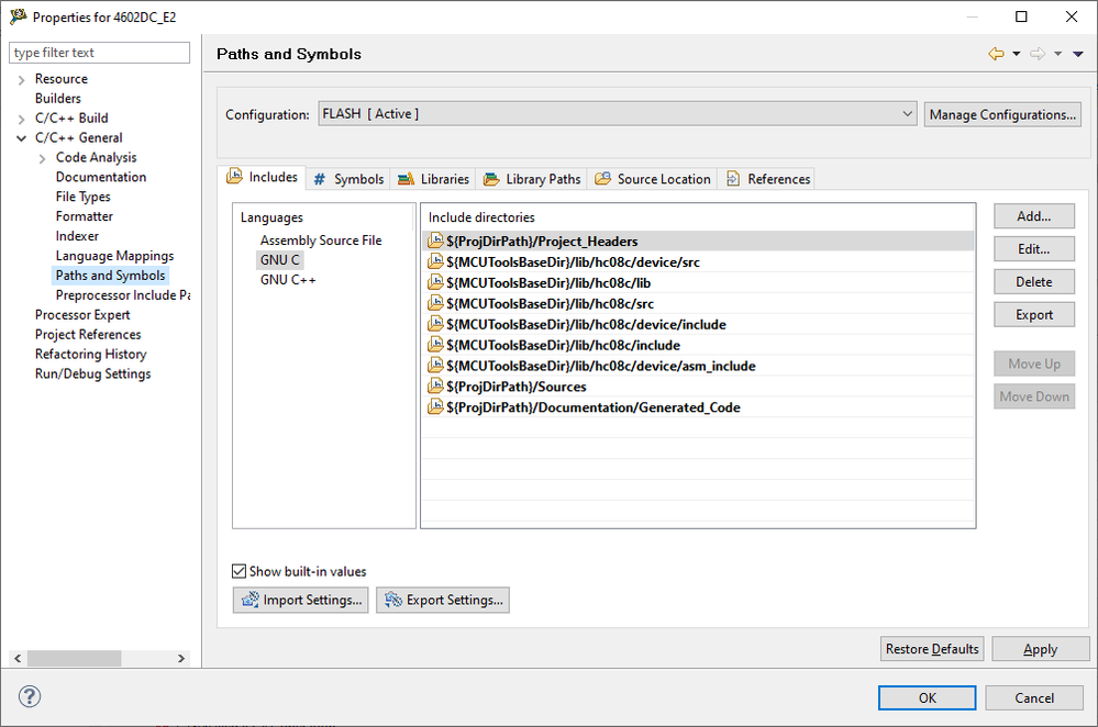

GaryOlmstead
HI Erich --

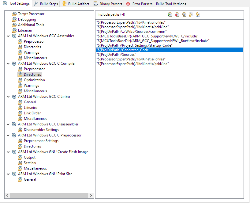

The closest I could find was this:
I modified it to look like this (added the last two lines):
But all it did was lose a bunch of other files:
I'm not sure what this means.  The objects it is complaining about are defined in the folder Sources, which is four lines up from the bottom in the Paths and Symbols list.
2,949 Views
BlackNight
Hi Gary,
the 'Path and Symbols' are only for the Eclipse Indexer (see Fixing the Eclipse Index | MCU on Eclipse ), but do not help the compiler to find the header files.
The setting (-I include option) for where the compiler can find the header files are in the C/C++ Build group, as shown in my screenshot.
I hope this helps,
Erich

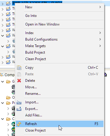

BlackNight
Could you post a screenshot of what you see or more details?
Do the files actually exist on the disk, but are not displayed in the project explorer view?
It might be that you need to do a F5/Refresh on the folder in Eclipse.
I hope this helps,
Erich

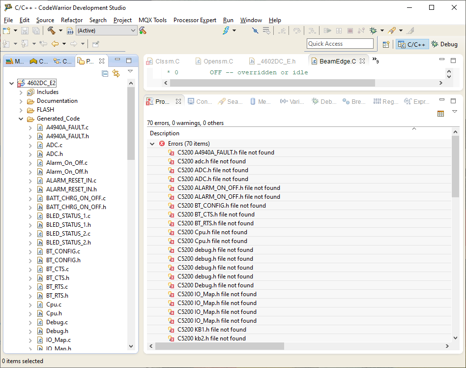

GaryOlmstead
Hi Erich -
Thanks for replying so promptly.  I tried the F5 command, it didn't help.  Here is the screen shot. As you can see, the files listed as "not found" on the right are clearly visible on the left.  This all worked perfectly up to yesterday morning.  I don't know what changed; nothing on purpose.  I was editing files, but none of these, and none of the "overhead" files, such as make files and the like.  I was only changing one or two  ".C" files.
2,949 Views
BlackNight
Ah, now I see. It is not about the IDE, it is about the compiler not finding the header files.
Check your compiler include path settings if it includes the correct include paths:
I hope this helps,
Erich
