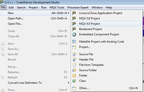

I normally follow the readme.txt instructions for the CW 10.n installation for extensions and they have worked. But there is no
C:\Freescale\Freescale MQX 3.8\tools\codewarrior_extensions\CW MCU v10.3\install_cw10.3_plugin.bat
after the CW10.3 install. In fact I don't even have a CW10.3 directory, I still have CW10.2 directory but the CW program says it is 10.3?
I did the updates from the web which seemed to install some MQX 4.0 extensions but I saw nothing for CW10.3, MQX 3.8.1.
Can someone point me to the correct file to add the TAD extension please or let me know what is missing? I don't want to go to MQX 4.0 we are near the release of a product and can't take the risk.
Thanks for the help.
Robert

Hi Robert,
Don't know if you have already solved this but the answer is that MQX3.8.1 extensions are already part of the CW MCU v10.3 product and should be automatically installed with it.
So, if you have installed CW MCU v10.3 you should be able to see the menu for creating a new MQX 3.8 Project3603_3603.png

I re-installed CW and now the TAD extensions are working; I have no idea why this stopped working.
