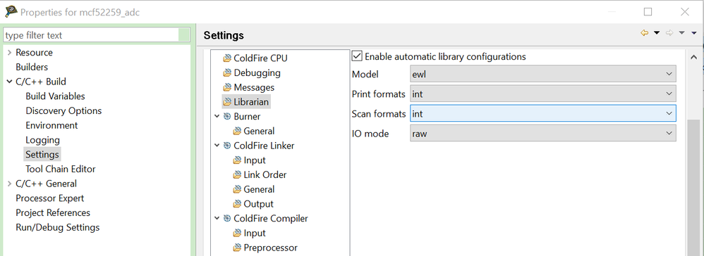

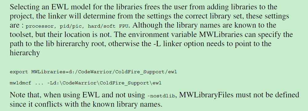

There with below description at <CWMCUCFCMPREF> document:
The CodeWarrior project for ColdFire product with below auto EWL library configuration:
The related ColdFire Linker with below options:
" -m __startup -L"C:\nxp\CW MCU v10.7\eclipse\../MCU/ColdFire_Support/ewl/lib"

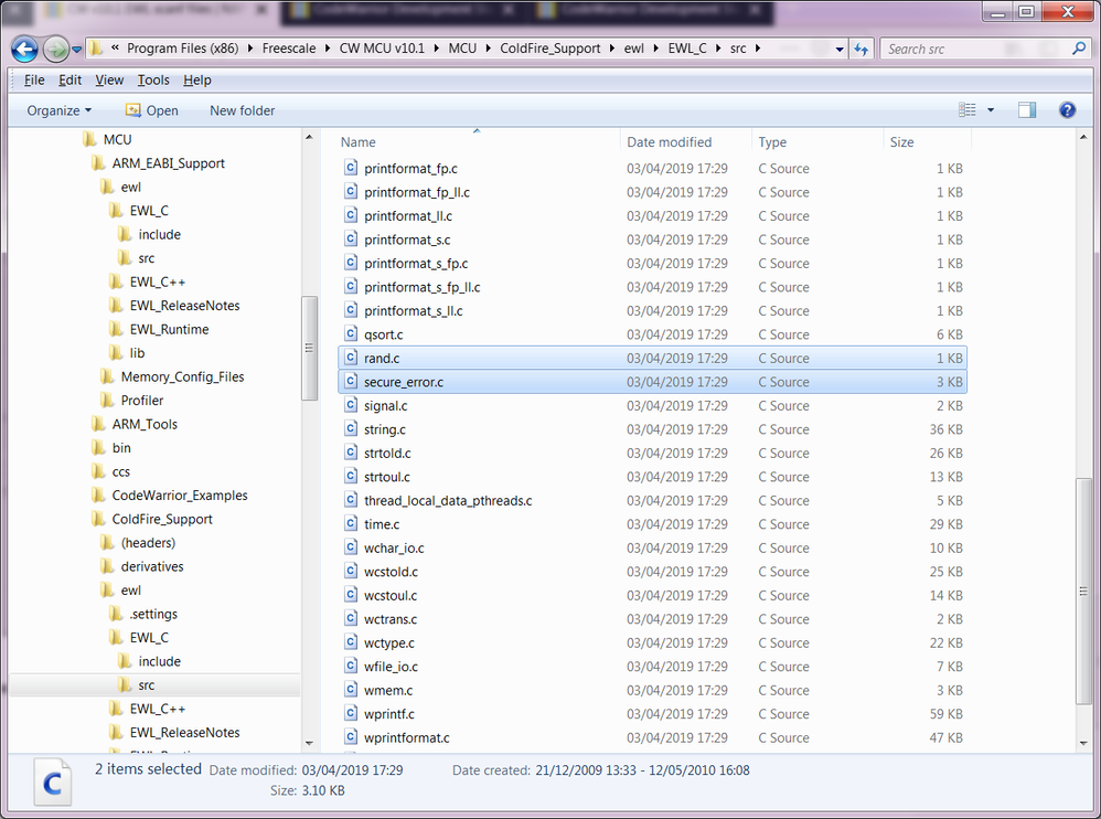

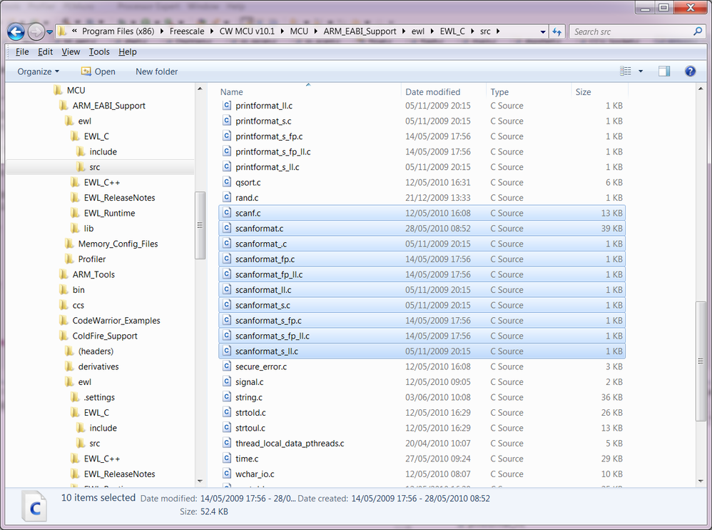

julio_perez-arr
Thank you for you response.
My question is: in the same way that "scanf" standard C library funcion files are defined for ARM Support:
where can I find the same files for Coldfire Support ?

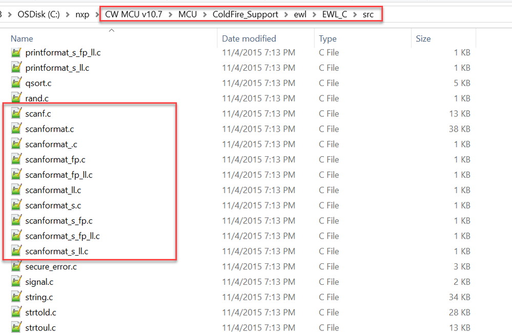

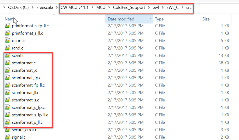

Hui_Ma
Hi KR,
I could find my installed CodeWarrior for MCU V10.7 with those files:
I would recommend to download and install the latest CodeWarrior for MCU V11.1 software.
