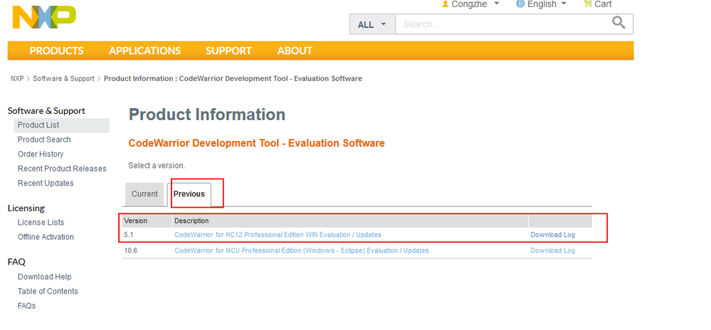

I am trying to use CodeWarrior V5.9 as an evaluation, but it does not expose a config for MC9S12DG256.  I saw online that I need CW V5.1 but I am not registered witha product to put in a registration Code, even though I have bought a few chips and I'm using a Dragon12_Light test board for evaluation.  Can you help me out?

Hello David,
I think your CW is CWS12v5.2, please download v5.1 .
After you click the download button of CW v5.2 , then select the Previous button, you can find 5.1 .
Hope it helps
Alice

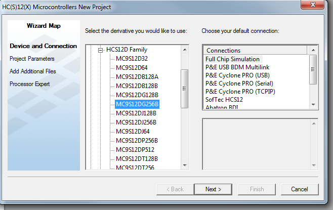

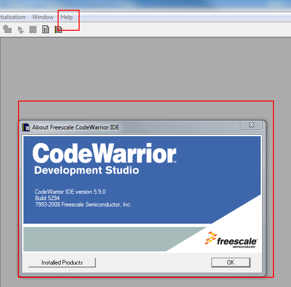

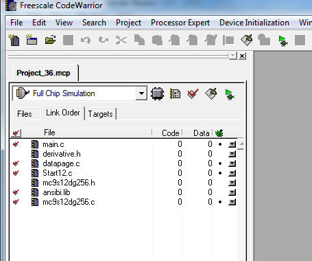

Hello  David,
The version of CWS12V5.1 is CW IDE 5.9.0 (they are the same one IDE):
And in this IDE, you can create project about MC9S12DG256
after finish, you can find the project :
Hope it hleps
Alice

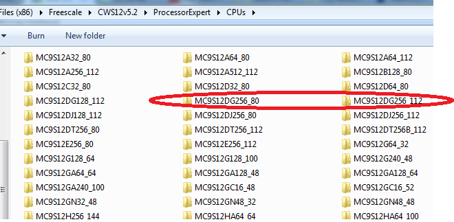

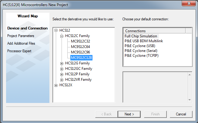

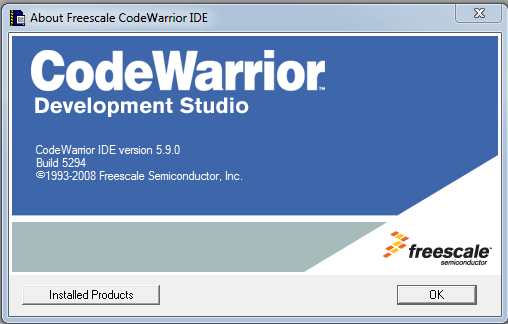

1,441件の閲覧回数
davidgrigg
Alice,
Thanks for the reply, However, here are my screens.
But no HCS12D Family in list.
Even though I see that there is a folder for it in the install CPUs directory.

Hello David,
Hope it helps
Alice
