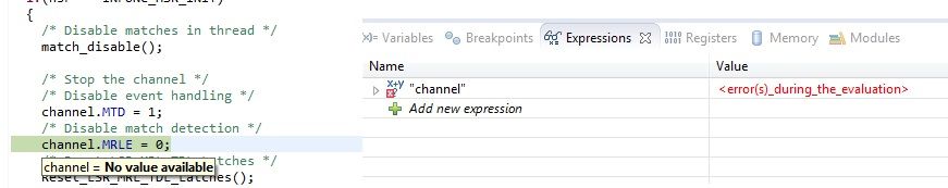

I am using "CodeWarrior Development Studio for eTPU" v 10.3 and a trivial code, after debugger start it does not know how to display ANY value - shows "NO value available" and when dragged to WATCH WINDOW says "Error(s)_ during evaluation"). Debuggers steps through code but I can not watch any value ! So it is useless.

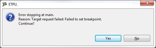

I also (sometimes, not always) get error when starting debugger :

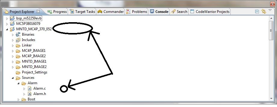

So, the active project and the tick box's to include files in the build have just gone missing like old times. Any idea how to get them back? How do I disable a file for the build without the check box?
11,263 Views
BlackNight
about "How do I disable a file for the build without the check box?":
You can do that per file using the properties menu, then C/C++ Build > Exclude resource from build.

BlackNight
Your screenshot shows the 'Project Explorer' view, which is the standard CDT/Eclipse view. That view does not have that capability. Switch to the 'CodeWarrior Projects' view (right hand side of your screenshot).
BTW: to enable/disable columns, you can use the small triangle:

CarlFST60L
Senior Contributor II
Thanks on both accounts :smileywink: I accidentally closed it and opened the wrong view... not quite sure why they have two options, 1 that has features and one that is dumb... but anyway... Its back!

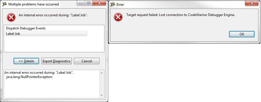

Ok, so now when it 'locks up' and I kill DE.exe as above, the real errors may be seen here? or maybe some more hints for the developers as to what is the underlying cause? Who knows, but this might help
11,253 Views
BlackNight
What you should see after killing the DE.exe is a dialog from eclipse telling you that the CORBA connection to the debugger is gone (well, that's what it is, we killed the de.exe). If that happened during download/flash programming, then another dialog should come up telling that the programming failed (which makes sense too).
But your two dialogs are something different. They let me think that there could be some underlying (Java???) issues on your machine, really hard to tell. I have sent you an invite so I could look at your machine configuration (in case this helps).
