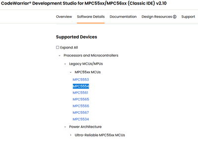

网页显示里面有这些型号没有5554 这个会影响使用嘛
MPC55xx device support:
MPC5514E/G
MPC5515S
MPC5516E/G/S
MPC5517E/G/S
MPC5533
3,788 Views
lukaszadrapa
I'm sure that CW 2.10 supports MPC5554:
