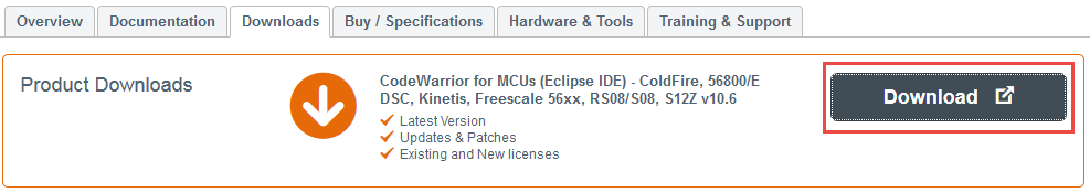

There is a new version of CodeWarrior for MCU v10 is available in the download section of CodeWarrior for Microcontrollers-Eclipse IDE|Freescale:
Use the 'Download' button:
You find the update under the 10.6 section:
This leads to the latest v10.6.4 version:

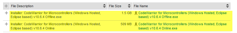

The software for download is available with two variants:
  • 'Offline.exe' (recommended): this installation image includes all supported architectures (S08, RS08, ColdFire, 56800/E (DSC), Qorivva, S12Z, Sensors and Wireless charging devices). Recommended for offline installation or in case of problems with internet connection.
  • 'Online.exe': this installation image contains the common files, and all the architecture specific files are downloaded on demand during installation.

Hi Erich, I cannot find the Offline Evaluation v10.6.4, I just found the Online Special v10.6.4, do you know where can I get it? Thanks!
Hi Carlos,
both are in the same place as shown in the screenshot above. It would be helpful if you could post a screenshot.
Erich

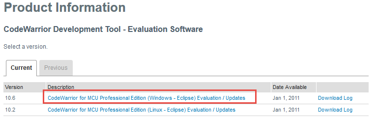

Going to the provided link and then to "Download" tab, and clicking "Downloads" gets me to sign in, when doing it I get this screen:
There's no Windows version listed in Current, then I click Previous and find one:
Then, I click it to list all the available downloads:
And there's any v10.6.4 available to download, I wonder if it depends on login credentials.
Thanks for your attention!
Checked on my side and the 10.6.4 is listed.
You can access this page by the link:
    CodeWarrior for Microcontrollers-Eclipse IDE|NXP
Then click on Downlad Eval
If you click on V10.6.4 you will jump to:
Pascal
NXP Technical Support
I had to create another account so the new credentials allowed me to see the file, very weird that with this account I don't have access to it. I've checked it again with this account after downloading CW v10.6.4 and the new Update 6 with the other one and still I can't see it with this one. Thanks Erich and Pascal for your support!
