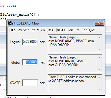

My data is stored in the paged flash area, When I monitor this address 0xe08000, I set the PPAGE=0xe0, However, the program is running error, How should I set it or have another method?
PAGE_E0       = READ_ONLY   DATA_FAR IBCC_FAR  0xE08000 TO 0xE0BFFF;

In this case, pointer is necessary. however __pptr is not available , because it will change PPAGE register too. We have to use __far instead. With "__far", GPAGE is modified, global address is potentially used but user needn't modify other code and prm file.
see attached demo code.

but , In your code, If I access the 0xC28000 address data, That's what I do
volatile unsigned long mybyte,test;
const unsigned long * __far myPpagePointer;
void main(void) {
  volatile int i = 0;
  myPpagePointer = &myBigArray_extra[0] ;
  mybyte=*myPpagePointer;
  myPpagePointer = &myBigArray[0] ;
  for(;;)
    mybyte=*myPpagePointer++;
    i++;
 test=(*(unsigned char *)(0xC28000));
However, data is not available, If I want to get the data from this address,
I want to retrieve data directly from the paging address
What should I do?

please note key word "__far" is a qualifier for global pointer. while 0xc2000 is a logical address, you need convert it to global address first with HCSXAddrMap. this tool is in your debugger menu "component", "open..."
 Besides, __far keyword is important to extend address to 3bytes.
Thus revise your code like this can fix your problem:
 test=(*(unsigned long * __far)(0x708000));
