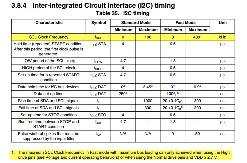

Hello, I'm using the interface I2C of KL25Z128VLK4 to generate a phase sinusoid. I need a frequency of 750kHz, but when the SCL frequency exceed 100kHz, I have a warning: the device is designed to operate up to 100kHz. So I'd like to know the limite maximun of the frequency of I2C of KL25Z.
PS: I have already tried to use a frequency up to 100kHz, but my output can't increase according to this frequency.

Hi Xiaocong Fu,
The maximum I2C SCL Clock Frequency of the KL25Z128VLK4 MCU is 400 kHz:
Hope it helps!

Yes, it helps a lot! Thanks!
