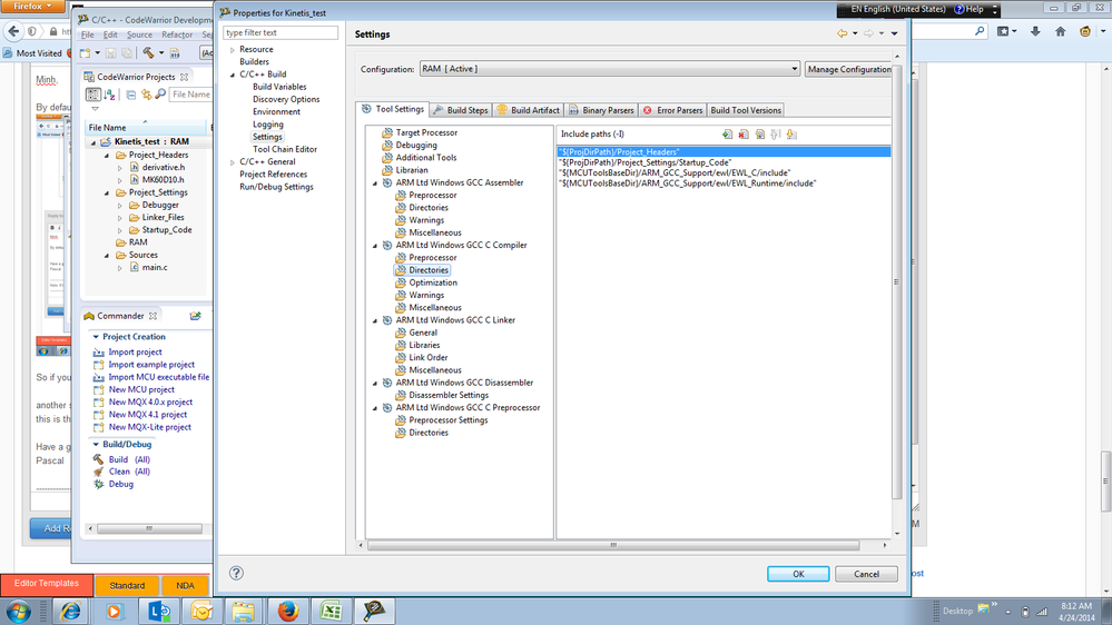

Hi Pro,
I try to create a project and I copy some source file from LED_LINK project.
But when I rebuild on other project , Codewarrior give me the message no such file or directory common.h
I added the common.h, but It seemS the compiler doesn't "see" the file.
please help me on this issue.

Minh,
By default when you created a new project , the Project Header folder will list all header files defined for this project.
So if you want to add a new .h file the best way is to move it in the Project Header folder.
another solution is to add the path of this new header file.
this is the solution used for the library inside the compiler settings
Pascal

Minh,
Pascal

trytohelp
Do you have checked in the LED_LINK project folders ?
Excepted the library files, all other sources files including header files used in a project example are provided in the project folder.
If you copy a source file, some header files must be copy too.
Can you check that ?
Pascal

nguyennhatminh
HI Pascal
Thank you for your help,
When I copy the source header file from folder project.
I checked , my current project also have some header file.
But I wonder why the compiler doesn't "see" that header file.
I solved the issue by creating a new file header and then , copy the content of common.h from sample project then paste to the new one created. => It works fine. :smileyhappy:

nguyennhatminh
hi Santiago_Lopez
Thank you for your reply , I'm using codewarrior 10.6 and the Perspective doesn't like the instruction.
I also added the directory "header file" and the compiler detect the common.h but can't detect arm_cm0.h....
and I can't solve my problem.
But I wonder what happening ?
If you have experience on this case, please share with me ,
Thanks a lot,
Minh.

Hi Minh,
It seems like you are trying to port some code from other compiler (like IAR) to CodeWarrior. IAR includes some header files and libraries that other compilers don´t. In your case, I think you need the common.h only to refer to the module registers. In this case, I would recommend you to replace the common.h with derivative.h (which is the CodeWarrior common header) this will refer you to the processor header file and will include all the register definitions.
The other option is look for the header files you are missing in the original project you are trying to port and add them to the CW project.
Saludos

Hi Santiago
Thank you very much for your reply.
As you know the common.h define things such as unit8 or unit32_t etc...
I solved the issue by creating a new file header and then , copy the content of common.h from sample project then paste to the new one created. => It works fine. :smileyhappy:.
