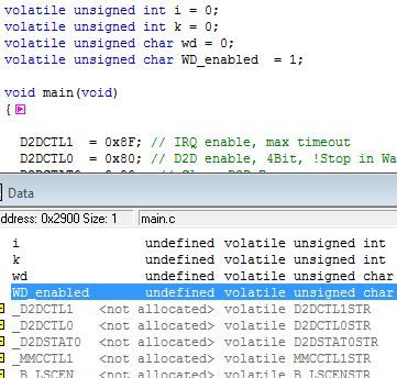

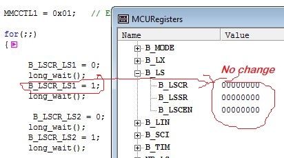

3, When I simulate my program with CodeWorrior True-Time Simullator hiwave.exe,  result is different with full Start/Continue(F5) mode and Step over(F10) mode, why?
    With Step over(F10) mode, some MCU rigisters and some variants I changed the value  in my code have no any change in CodeWorrior True-Time Simullator's detect windows, why? As below:

3. regarding to the left side picture, i wonder you debug the project in full simulation mode without connecting board. in full simulation mode, not all hardware register can work normal. you need connect a board to make sure register view perform full function work.

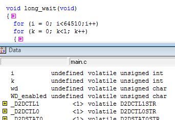

regarding to the right side picture, i wonder it is an optimization problem, please cast the related local variable with volatile:
volatile int i=0;
this should fix the problem.

For the question 3,
Actually, I did connect board, I can drive my motor normally.
How to understand "make sure register view perform full function work"?
For the local variable, also I already cast with volatile, as below.
I else can't detect the real-time change at Stepped Over mode.
Thanks!
Best Regards
David Dai
1,864 Views
ZhangJennie
to avoid optimization, volatile is used for local variable.
for global variable, adding the variable name in prm file ENTRIES section can avoid being optimized. for example:
ENTRIES /* keep the following unreferenced variables */
variable_name1 variable_name2
END
can this help you?
