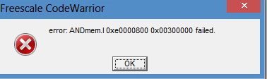

When I use CodeWarrior8.8 to connect to the target board (mpc8377), there are the following errors:

When I use CodeWarrior8.8 to connect to the target board (mpc8377), there are the following errors:165633_165633.pngQQ截图20161009181450.png

Please try whether it would be helpful to use CodeWarrior JTAG configuration file to override RCW.
Please configure JTAG configuration file from Edit->Debug Version Settings->Remote Debugging->Edit Connection->Use JTAG configuration file.
Please use and modify the JTAG configuration file C:\Program Files (x86)\Freescale\CodeWarrior PA V8.8\PowerPC_EABI_Support\Initialization_Files\jtag_chains\837xRDB_rev10_HRCW_jtag.txt according to your target board. Please pay attention to RCWLR[COREPLL].

yipingwang
When the boot sequencer is enabled, the e300 core must be prevented from fetching boot code, by setting the core disable reset configuration word field(COREDIS) in RCWHR. If the e300 core is required to proceed the boot sequencer should enable boot vector fetch by clearing ACR[COREDIS].
Please check whether RCWHR[COREDIS] is set.
Please check whether RCWLR[COREPLL] is configured correctly.

李鹏斌
Thank you very much for your reply. RCWHR and RCWHL are not configured at the time of the connection.
