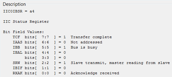

Thank you for your quick response. I connected the IICSDA and IICSCL lines to a scope. The IICSDA line is being pulled upto 4.5 volts and IICSCL line stays at 0 volts. I am not seeing a pulse in either of the lines. Do you think there is a register I need to set in order to see the clock pulses ?
I assigned the register IIC0IBCR register to 0xB0 which enables IIC bus module, sets Master mode and sets the transmit bit. Although when I do this the register IIC0IBSR gets set to 0xA4.
Do you think this could be one of the problems ?

Hello Mahendra,
- Please pay attention that , if you use the processor expert , you needn't configure
the registers for initialize I2C . After configure the I2C component , then the initialize
code can generate :
-From your detail of the IICSDA and IICSCL signal, i think the I2C have not been start ..
So recommend you first refer the demo i mentioned last time to test .
