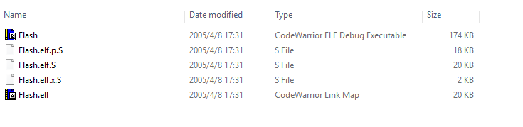

I am using CodeWarrior v8.3 for programming of DSP56807 controller with Codewarrior USB TAP ONCE debugger, I am unable to understand what type of output file is necessary to load to the program.
1,396 Views
xiangjun_rong
Hi, Sujai,
The CW tools can generate the *.elf file, which you can click "debug" in CW for DSP56800E tools  to download  to flash of DSP56F807.
As the following Fig, the first file Flash is elf file, the extension name is "elf".
Hope it can help you
