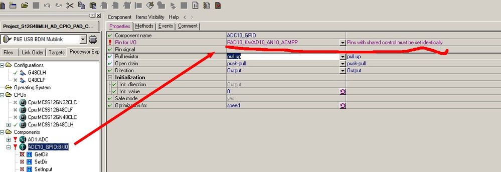

I am using S12G48 with LQFP-64 pin package, and want to configure AN0 ~ AN8 and AN11 as the ADC input, while configure AN10 as GPIO output at the same time,
I made my project with Processor Expert and CW5.1. and I cannot achieve the above requirements:
when I configure AN10 as GPIO output, it will conflict with AN6,AN7 and AN11 as below screenshot:
I reviewed the S12G reference manual, but cannot find any information to explain the conflict.
Is it a bug of Processor Expert?
I attached my project and CW5.1 infomation for your reference and hope someone can help to solve it.
thanks~!

Hi Enwei,
this is a known issue and processor expert team has provided hotfix for this issue. see attached.
can this help you?

Hello Enwei
I reproduced the problem on CW5.1.
In the bitIO component in your project, I can select AN8, AN9 as the GPIO, but cannot select AN10. I’m looking into it, and will reply you later.
