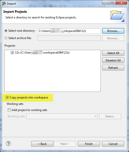

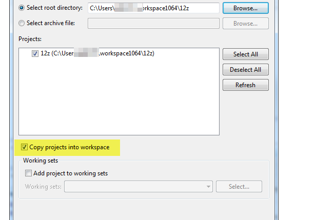

when you import a project to CW, if select "copy project to workspace", the project file(.project) and all the files IN and UNDER the project folder will be ported into your workspace. But if the project links the folders/files that are not under the project folder, these linked folders/files will not be ported by importer.
if you don't select "Copy projects into workspace", all the project files and folders will remain on the locations as they are.

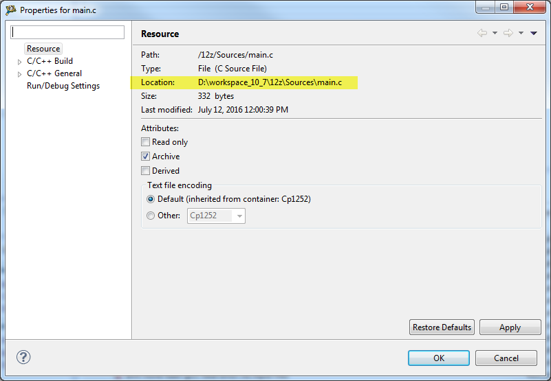

specifically, you can right click on the file from CW IDE, "properties", then view the file location:
here is where to check if the project files setting correct.

Thanks.  Working from a local drive was exactly what I wanted to do, but missing that single check box resulted in all of the follow-up questions and problems.  Proving once again that a warm body on the phone could have answered this in less than a minute.  INSTEAD IT TOOK FOUR DAYS!  The Help available in the IDE does not describe the interface in enough detail to have otherwise discovered this.  I'd recommend NXP/CodeWarrior personnel address both shortcomings.

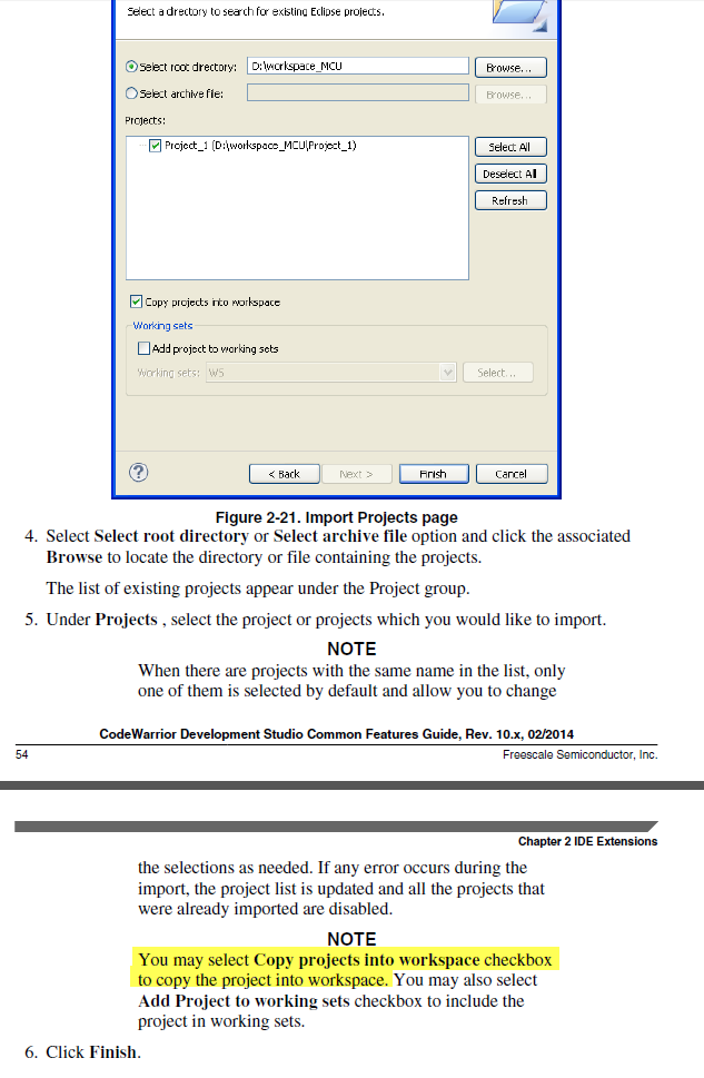

Under the CW10.7 install, there is document CodeWarrior Common Features Guide.pdf. Selection "Copy projects into workspace" is mentioned in NOTE, as I highlight below:
As I said before, when select "Copy projects into workspace", all the files IN and UNDER the project folder will be imported into your workspace. and you work on the project files from your workspace. Otherwise, all the project files are still in the original folder as they were.

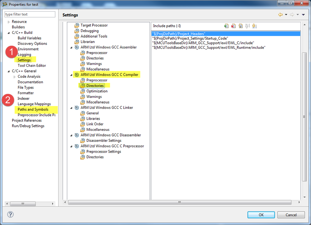

As you said, in your project, your project can only work with checking "Copy projects into workspace" option. I think this should associate with your project file path setting, I guess your project path setting relies on the workspace path. here is of where to check the path setting. pls check same on your side.
